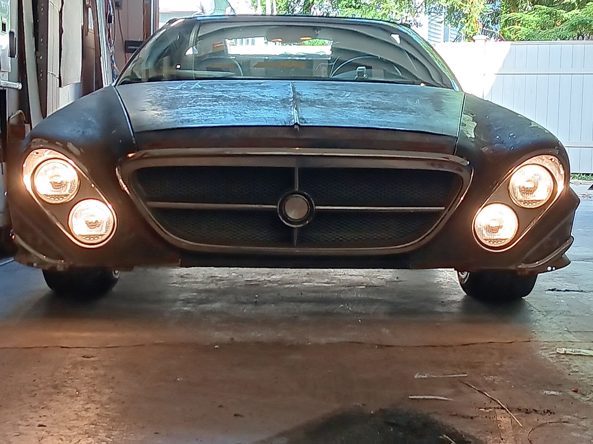

It looks like the 4 High harness will activate all 4 headlight filaments but doesn't say anything about allowing the fogs on with the high beams. Hidden, undocumented feature maybe?
I understand the illegal, unneeded arguments, but this car isn't your normal C5. It's been rebodied and has a ridiculous rake making the headlights pretty useless. I'm just trying to get as much light on the road as possible. The high beams are about equivalent of the low beams so illegal probably isn't a big issue. Here's a pic, the fog lights were added behind the lower grill.
I'm thinking of cutting up a spare trunk lock/fog light switch unit to change the fog light switch from a momentary BCM signal unit to a lighted rocker 12v+ switch then wiring my own relay and fog light circuit. Anyone done this? Will the BCM complain about being cut out of the equation?

Rebodied indeed....
