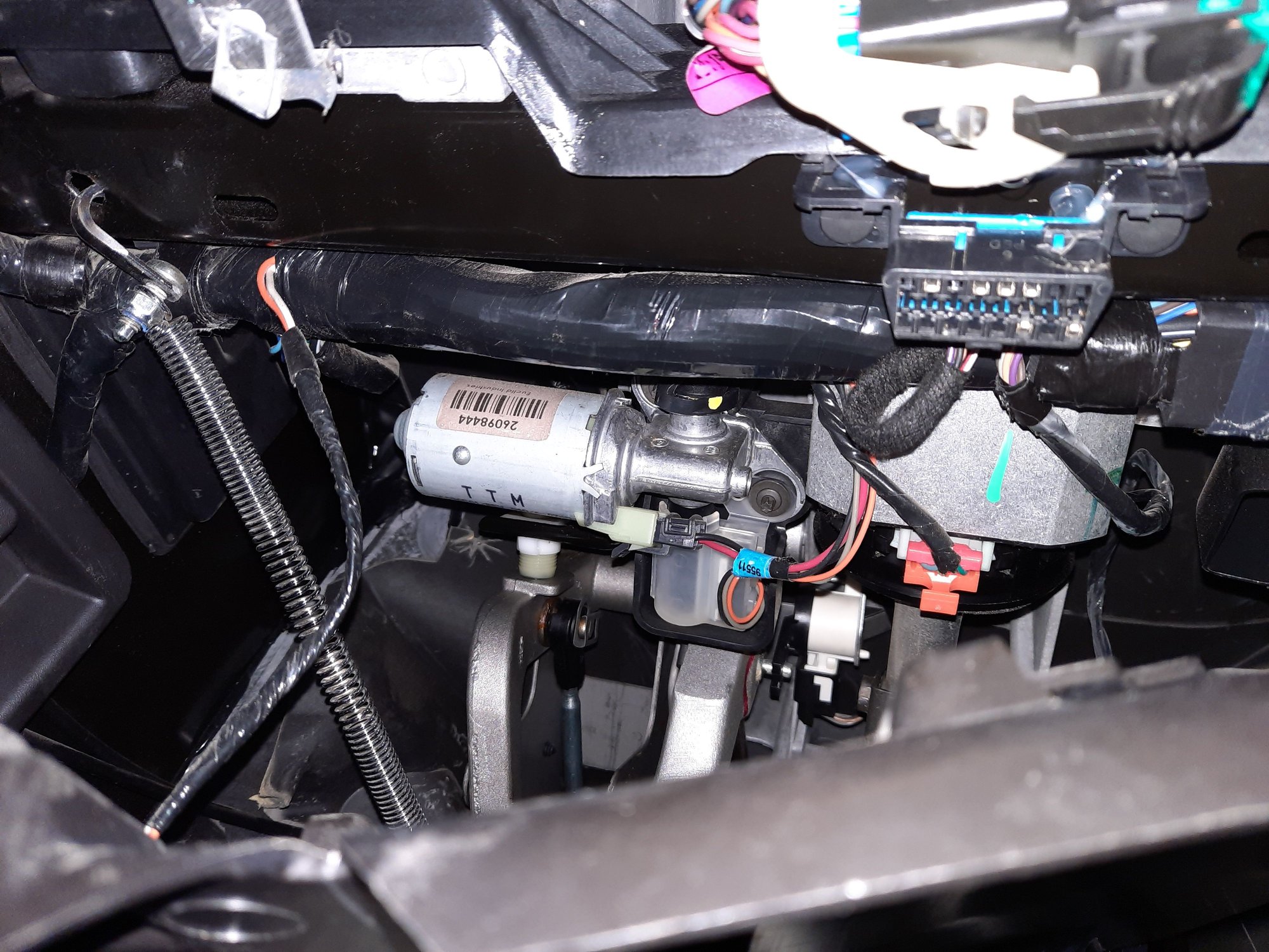

I have this US exported c6 Z06 -06 and want to put back original rear lights, prev lamps were with separate amber blinkers. The old wires in back were cutted and brake signal was taken from third brake light. I have new USA-wire harness but after putting it to car the brake lights are not working with US-lights, everything else works. So there is some other modification made. I do not think that car has been changed to euro spec from BCM, it still has tyre pressure monitor. SO is there some change made in front of the car, there is no "white wire" in brake pedal (attched picture). Should i take hazard button off and check it?
Hopefully you can help me... You can send me e-mail : ismo.reponen@irepoint.fi or reply this.
