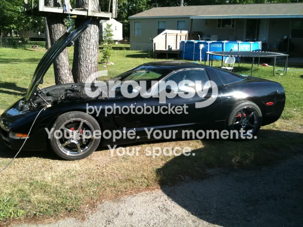

Just got a 99 c5 and there is a few things that need to be addressed
First the display on startup says shocks inoperative and maximum speed 80mph
Next neither wIndow will roll down and cant lock or unlock doors from driver side
I'm kinda Of a diy guy so I'd really like to fix these issues myself if possible
99 c5 black on black with 145k paid $8700

is that a battery charger?
weak batteries cause a whole bunch of problems in these vehicles.
Old Apr 21, 2011 | 10:10 PM
Twitch02x's Avatar
Twitch02x
Joined: Mar 2011
Posts: 35
Yes but have put a new battery in and still same stuff
