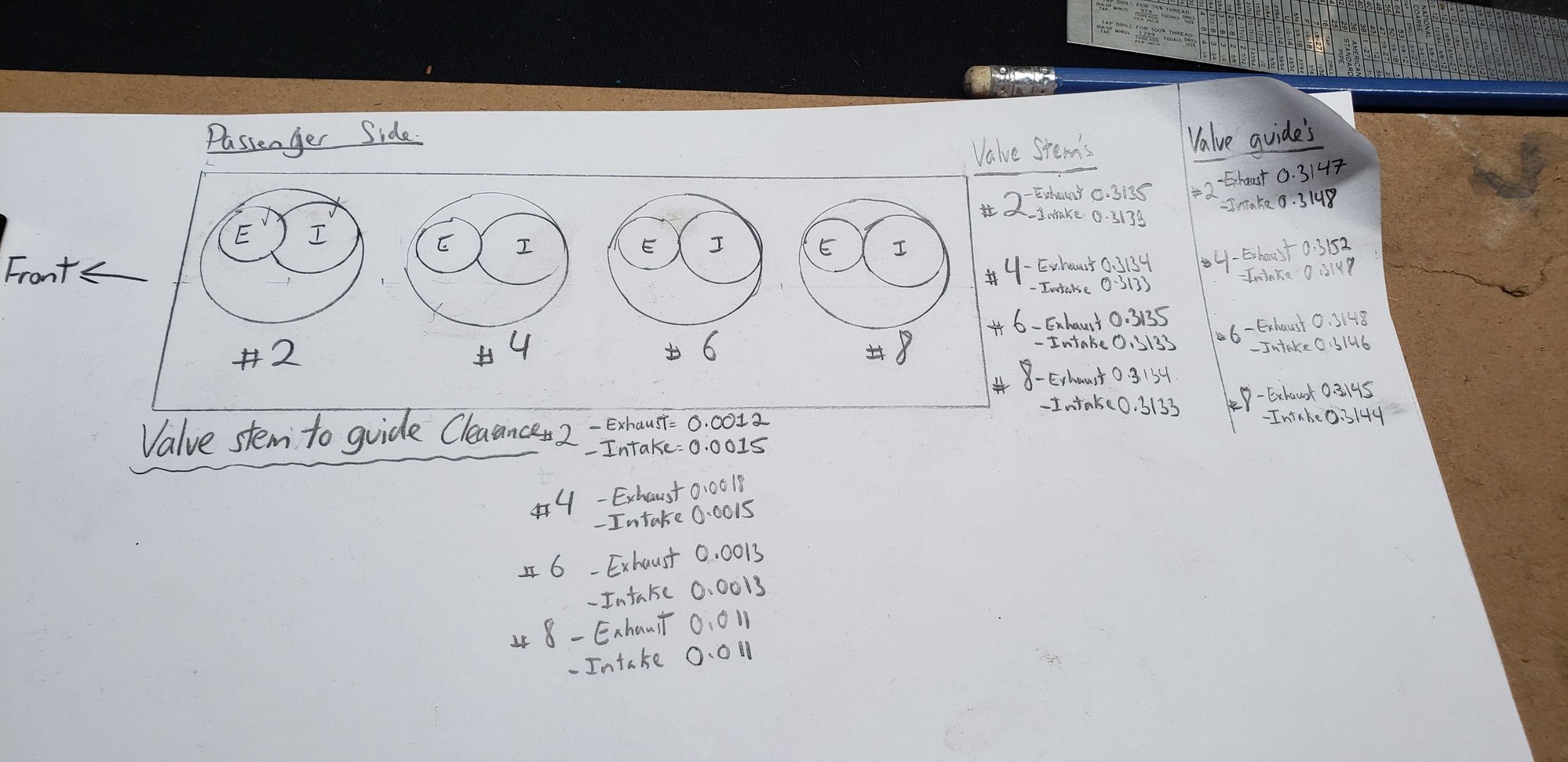

Use a micrometer and then check the numbers against the service manual.

Old May 25, 2019 | 06:47 PM
Georgies's Avatar
Georgies
Joined: Jan 2008
Posts: 1,235
Likes: 51
funny you say this. I'm almost done measuring each valve stem and guide on the passenger head. Almost doe will post result soon.
SO FAR SO GOOD!!!!
My mistake was using the vernier!!
Old May 25, 2019 | 07:12 PM
Georgies's Avatar
Georgies
Joined: Jan 2008
Posts: 1,235
Likes: 51
Old May 25, 2019 | 09:27 PM
redzg's Avatar
redzg
Joined: Mar 2017
Posts: 3,770
Likes: 940
From: Orlando Florida
Them there be some classic measurement tools. Not exactly handy on the shelf at Harbor Freight...
