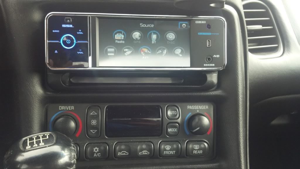

I finished the install at lunch. As you can see the face of the radio is very deep and sticks out quite a bit. I took some pictures of the install and various screen shots. It is very bright outside so it's a bit washed, but the screen is 600 NITS.
I need to use the stereo for a while to see if there's anything I don't like but it all works great for now. The unit drives the stock speaker at full tilt at about half volume so it's very powerful compared to the stock HU. In fact, with the car off and the volume on 1, it's a little too loud for quiet listening.
Couple of notes for the install. Install the sleeve into the bezel outside of the car so you can bend the tabs. There are 4 key tabs to bend down, but I also inserted a couple of screws for extra support and ground them off. The blue antenna wire goes to the blue/white amp wire on the Metra harness. The actual antenna wire from the car harness is apparently integrated into the Metra controller, but it all works correctly and I also have the RAP working. I connected the parking brake wire to ground and video works from a DVD so far.

The display looks pretty good, but I think the mounting looks pretty ugly sticking out like that. Is it the radio chassis what sticks out so much or the mounting adapter you used?
Old Mar 2, 2012 | 08:01 PM
carhopper's Avatar
carhopper
Joined: Aug 2011
Posts: 87
From: Dandridge TN
Yes I agree. It was a combination of the mount protruding and radio face thickness. I'm not sure how to recess it with that mount. the mount by itself finishes out well.

It was dark and raining yesterday during the install and tornados were coming so I was in a hurry. Attached is a good side picture showing that the mount has a bezel that is pushing it out at least 1/4". This could be trimmed with a cut off wheel on a dremel, but I'm sure there's another mount kit that doesn't have this big lip. They probably did this to accommodate the pocket. The face of the radio is also very deep.

I just ordered the Metra 99-3300. It actually recesses the radio and will be much cleaner. So I was the guini pig and lost $12 on the first mount. At least now we know. The pocket is perfect for a cell phone though so I will miss having it.

Here are the pictures with the 99-3300. It looks much better and is recessed almost to the point where the door just clears when opening for DVD. The radio is back as far as it can go. I had to bend the OEM radio mount down slightly and remove a cable bracket across the back to provide additional clearance. This I can live with.
