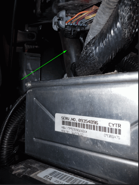

Does anyone know where the passenger side cowl drain is located? I am trying to find it and can not seem to locate it.
Old Jun 22, 2019 | 01:57 PM
oelarse's Avatar
oelarse
Joined: Jul 2011
Posts: 991
Likes: 306
From: Southern Norway , Europe
You can remove the battery or look behind the PCM inside the front inner fender

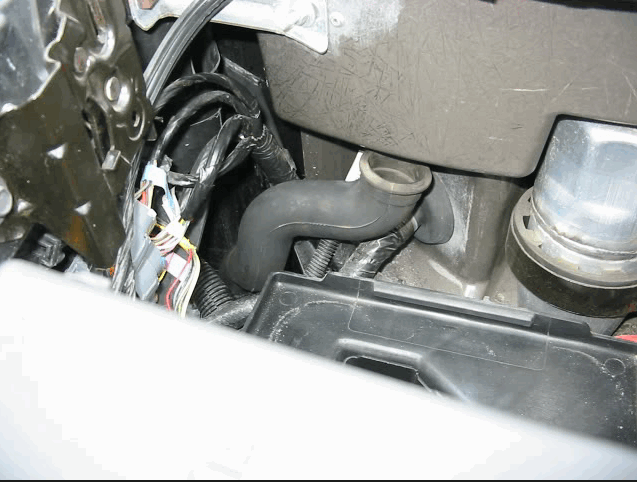

Old Aug 18, 2025 | 07:27 AM

Originally Posted by Bill Curlee
WHAT EVER YOU DO, DO NOT pull the passengers side cowl drain out of where it lives. It will come out but you will play hell getting it back into its proper place
Just pop it out of the cowl and blow it out with a garden hose. If there is anything in it, it will easily flush out of the bottom. It easily pops back into its hole in the bottom of the cowl.
The reason that GM put the weird, shaped tip udders on the cowl drains is to prevent under hood heat, vapors, gasses and smells from entering the cowl area. The cowl area (trough) is where the HVAC collects it outside fresh air when you are not in recirc mode. The lips on the ends of the udders close together when not draining water. With out the udders, the hot under hood air can get sucked into the cowl/HVAC outside air intake.
The C6 does not have udders. It has a slim rectangular shape opening on either side of the cowl with a flap to allow water out.
The C5 does NOT have a HVAC fresh air intake filter to filter out dust, dirt, pollen and junk in the air. The C6 has a filter
Don't forget about the HVAC Air Box Drain on the firewall. It too has a little 1/2" rubber 90 deg boot with lips that let the water out. The lips restrict how much fresh air comes out of the air box drain. Without the little rubber 90-degree rubber boot with the lips, a significant amount of cold air exits the airbox though that open 1/2 hole into the engine compartment.
The lips of the boot can stick together and prevent that air box condensate water from draining out of the airbox. If it can't drain out, it WILL DRAIN INTO THE PASSENGERS FOOT WELL directly on the BCM. NOTE!! The BCM does NOT like water!! If you see fresh clean water dripping out from under the passenger's side of the car where the firewall is when the AC is running, that's normal and desired/expected. If you do not see condensate water draining out when the AC is running, I highly recommend checking that drain boot and the drain tube. They can clog up with a snot type of slime and stop water from properly draining out of the air box.
The udders easily pop out and back into the underside of the cowl. On the rear of the fender liner (both sides)
is a removable access panel that can be removed to get proper access to that area.
BC
Bill, what is your opinion on snipping the ends off the udders? I know some people do and I can't think of any downside to that...your thoughts?
