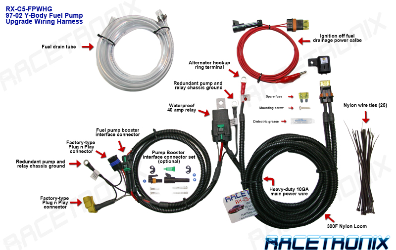

what is your Injector Duty Cycle? that is the importat question when the Cam goes in.
42lb injectors will get you where you want unless you go E85 the you will want 60lb injectors NA. When the fuel in your WET NO2 activates you will need to keep feeding the injectors as well as the NO2 system so you will want a good pump, harness. few venders offer them. Casper and Racetronix have made things for my other GM cars might check there. I dont think you will need a Boost-A-Pump with a good intank and a harness but it wont hurt, never had them on any of my cars.
http://www.racetronix.biz/customkiti...sp?kc=RFPK-007
