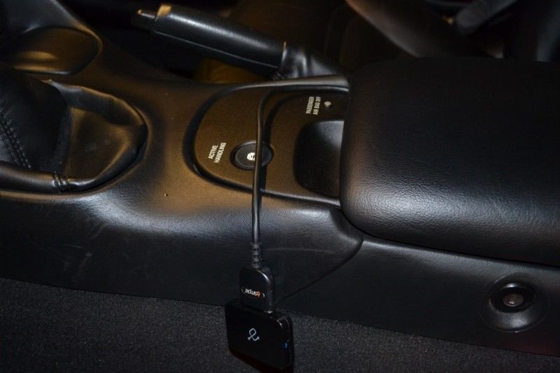

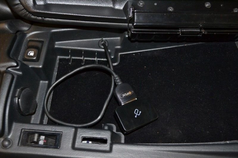

Like Sam said, for $75 you can get...
Peripheral PXDP PXHGM2 Chevrolet Corvette 97-04 iPod Adapter
Throw in a couple of Kicker plug and play upgraded speakers for about $80
http://shop.doubledmods.com/C5-Corve...ages_c1541.htm
Then get you a 30 Bluetooth Receiver from Bestbuy and you can play some nice quality tunes with your Smart phone thru your completely STOCK looking stereo... you can still play CD's in your head unit.
