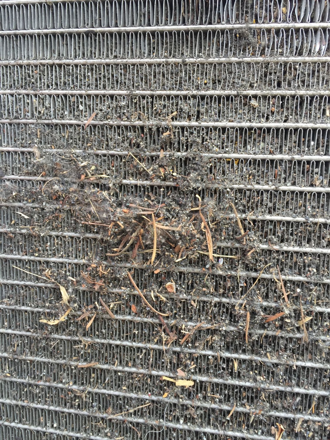

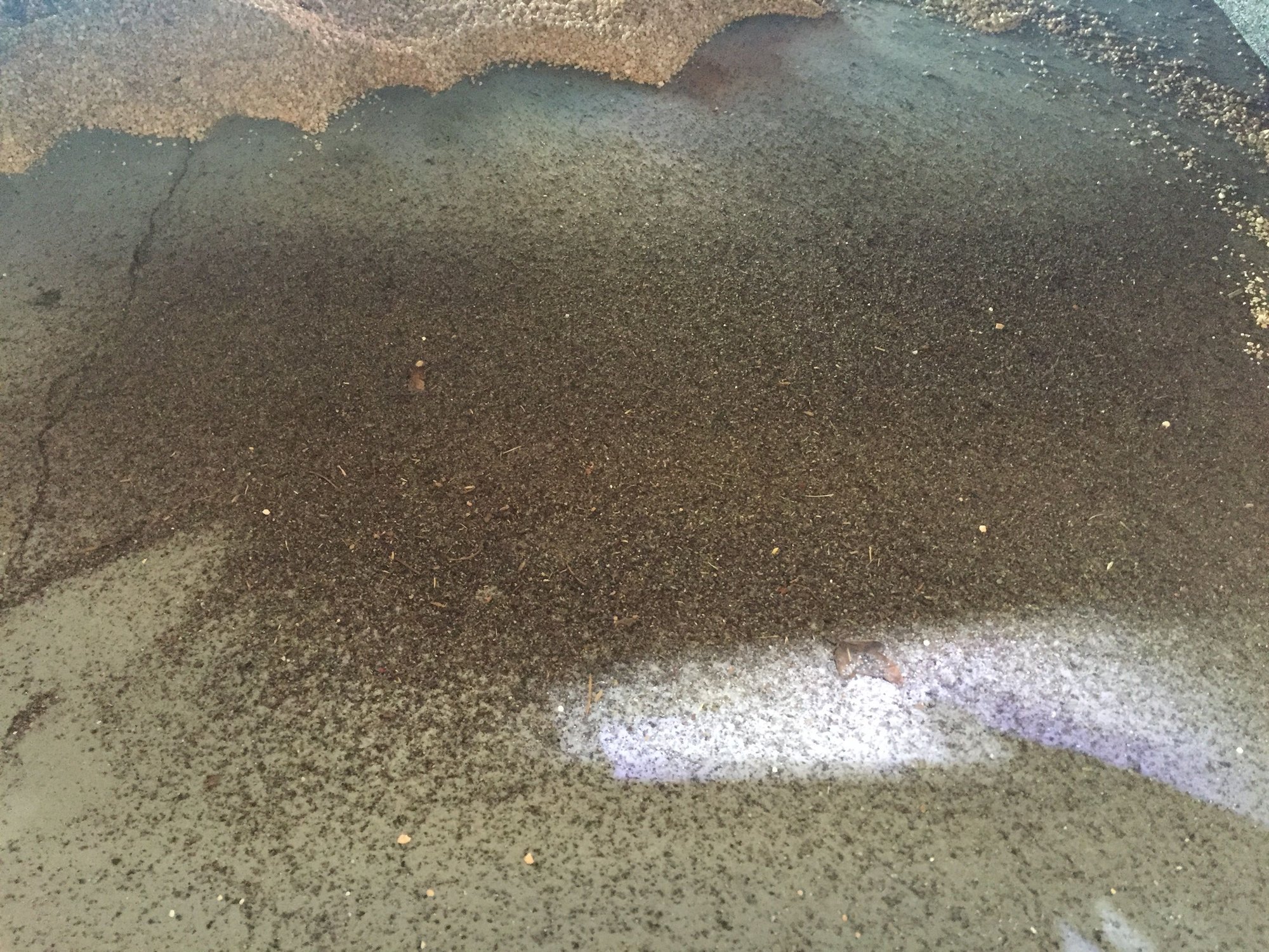

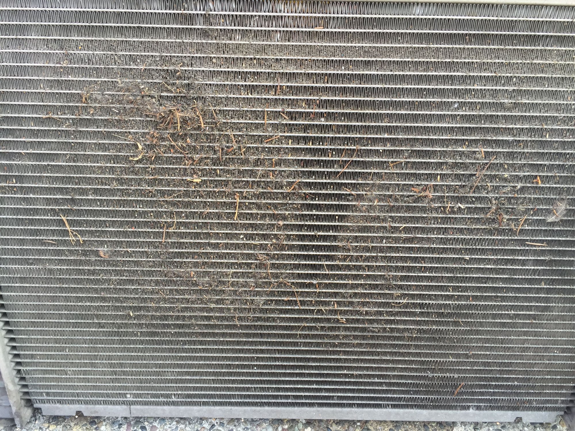

Here's the stuff that came out of the radiator just getting it out of the car. This isn't from on top or something, this fell OUT of the radiator fins...
And here's what the rad looks like. Yeah, not a surprise what's going on here. If you haven't had your radiator out or you're doing weird crap to get temps under control, spend 90 minutes R&R and cleaning this thing. Test drive in an hour or so.

OK, calling this fixed. Nice, steady 199 on the freeway, peak of 221 around town. Ambient is 92 degrees. I think those temps are ideal based on reading the Service Manual.
Total time was about 2.5 hours including the time spent cleaning the radiator and the A/C heat exchanger. Only real PITA was getting the shroud out and in.
IMHO, I'd start here if temps are creeping up.
Note that I'd been cleaning mine regularly with water...every once and a while, it apparently needs to come OUT to get really cleaned out.

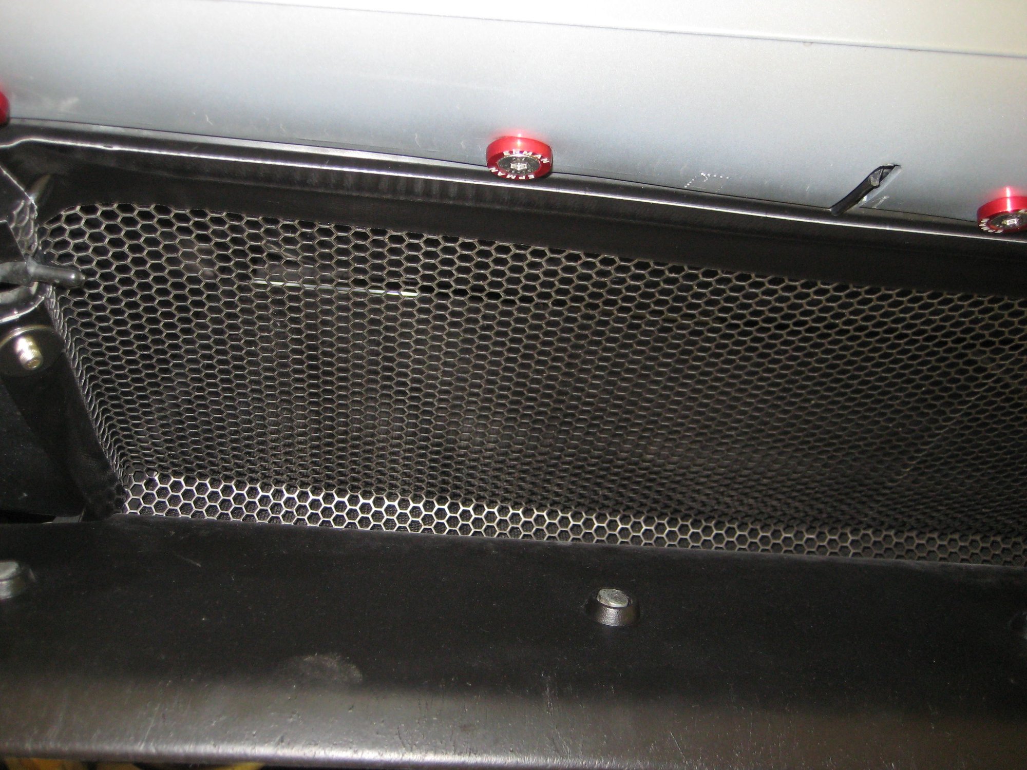

That is why I installed screens !!!!!
ten minutes with the vacuum and done

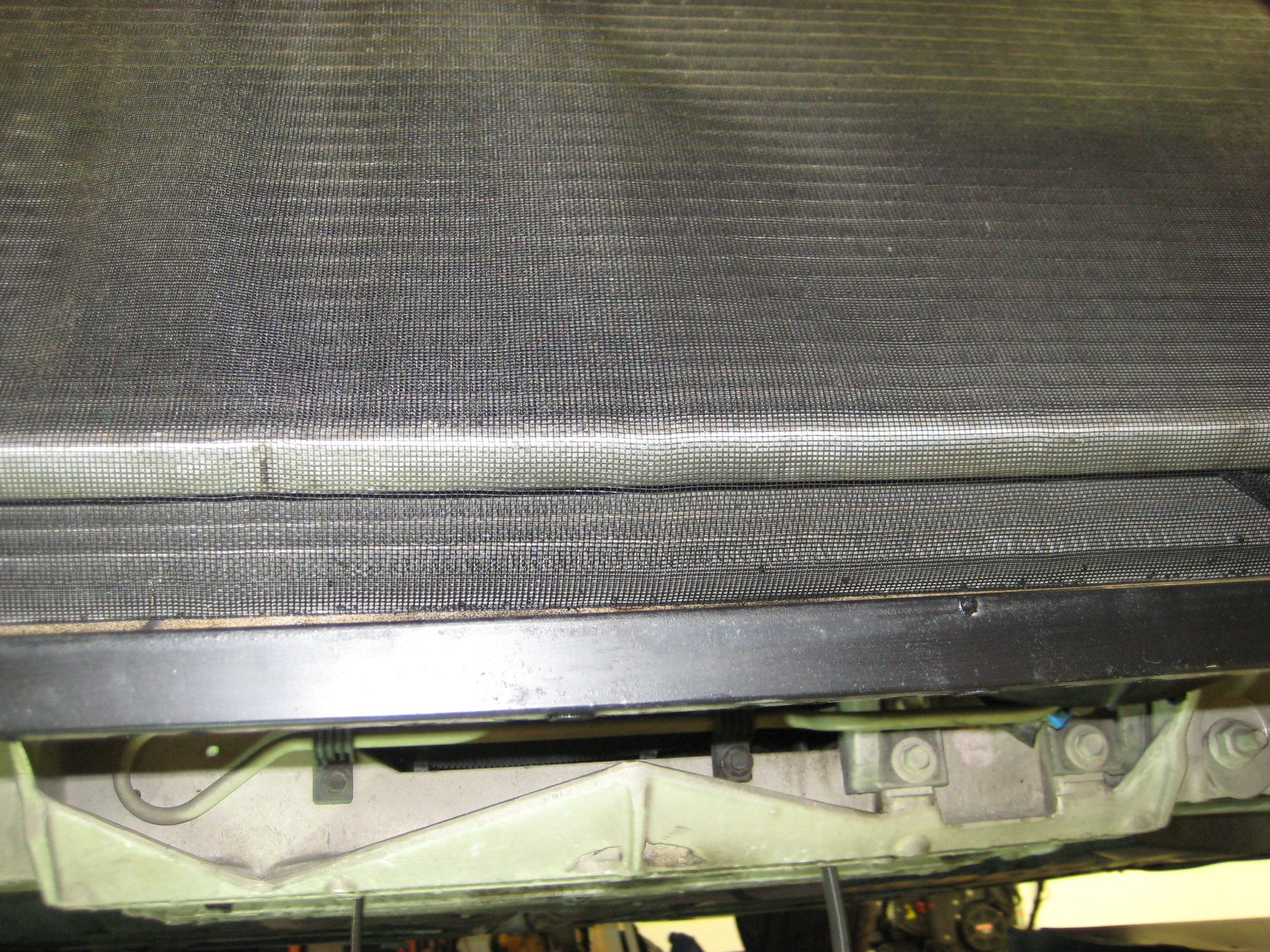

reply to fatfastboy, I had some aluminum channel that fit perfect over the top of the condenser with the screen sandwiched in.
Then I pulled the screen tight and cut a piece of wood to sandwich the screen in the bottom groove of the radiator. I also used foam weatherstrip to seal the sides.
I also made a bottom screen.
the screen is fine nylon.
