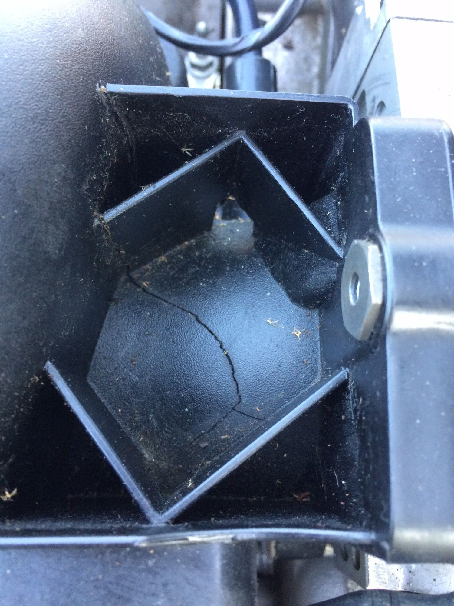

So I have a c4 with an ls6 I recently swapped. I haven't driven it out of my neighborhood until today. That's because I didn't have an exhaust and was just running open.
Today I went to get the pipes installed and after about 6 miles of very loud, but gentle running....it got very rough.
I was hoping that it was just not enough back pressure was messing up the o2s. But it turns out I had a crack behind the throttle body
1. Which is chicken, which is egg? The crack or the rough running?
2. Was this most likely cracked when I got it 6 months ago, and I just didn't notice until it heated up?
3. Anything else to check?
4. Can I just solvent weld this, or is the intake toast?

Any thing is possible. Clean the area with solvent. Stop drill the cracks where they stop. Use a dremmel or air drill and rough the area and V notch 1/2 way thru the crack on top. Use some 2 part epoxy (JB Weld works excellent) and fill in the damaged area. Do the same repair on the inside.
Cover any other cracks with epoxy. Let it cure and do the inside.
I would look carefully for other cracks. Looks like back fire damage.
Spray the manifold with solvent and let it evaporate. Any cracks will stay WET longer because the crack retains the solvent longer.

Thanks....do you think it backfired from no pipes causing the computer to run it lean?
I'm new to the LS engine so trying to figure what caused the crack or if it was the cause

Check to be sure there's not something underneath the manifold making contact, causing it to crack when the bolts were tightened.
Check the front engine cover and water pump area to see if the manifold is resting on it.

I agree with post 2 and 7. Check the fit on top of the air bleed pipe. I know my fast 92 wouldn't clear. Test fit it without the gaskets/seals. It should rest easily on the heads with no rocking.

it was running fine then all of a sudden felt like it just wanted to limp. If I turned it off (on the side of the road mind you) and started it back up after a few minutes of looking around for obvious causes, it was ok again. I originally thought the fuel pump wasnt delivering enough fuel, or that a coil pack wire had come loose. it was running very rough and sounded like it was not running on all 8. But then when I restarted....everything was fine and smooth....just got bad at speed.
....do you think it backfired from no pipes causing the computer to run it lean? What else could cause the backfire? I am going to try and plug the leak enough to get home, and to prove that is all that is wrong. I will put another intake on it, but I dont want it to happen again....assuming I did it at all...could have been there before and I didnt notice it.
