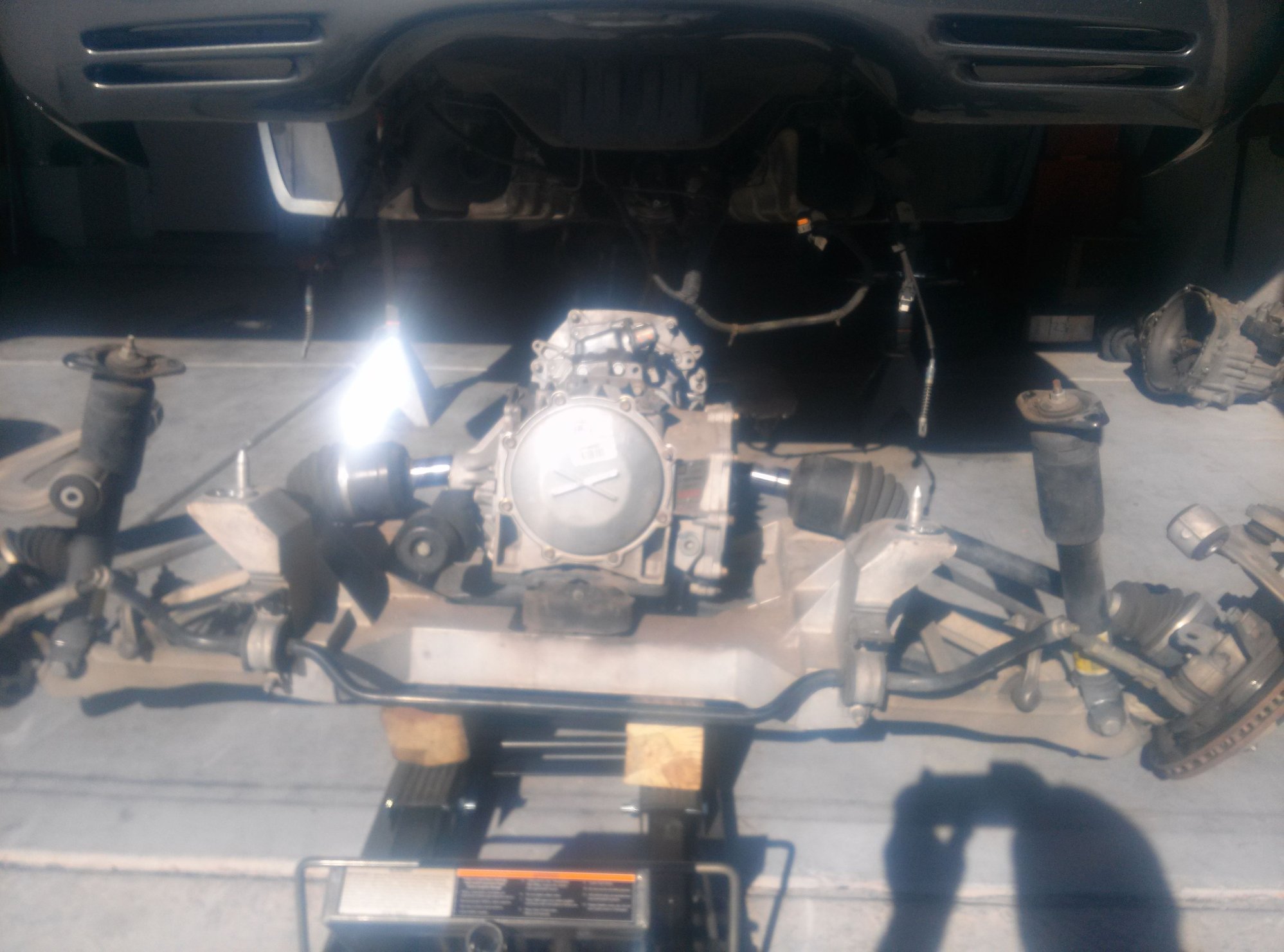

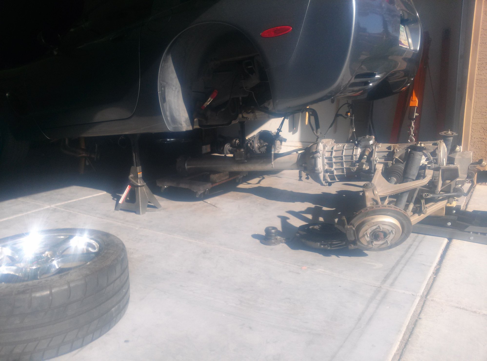

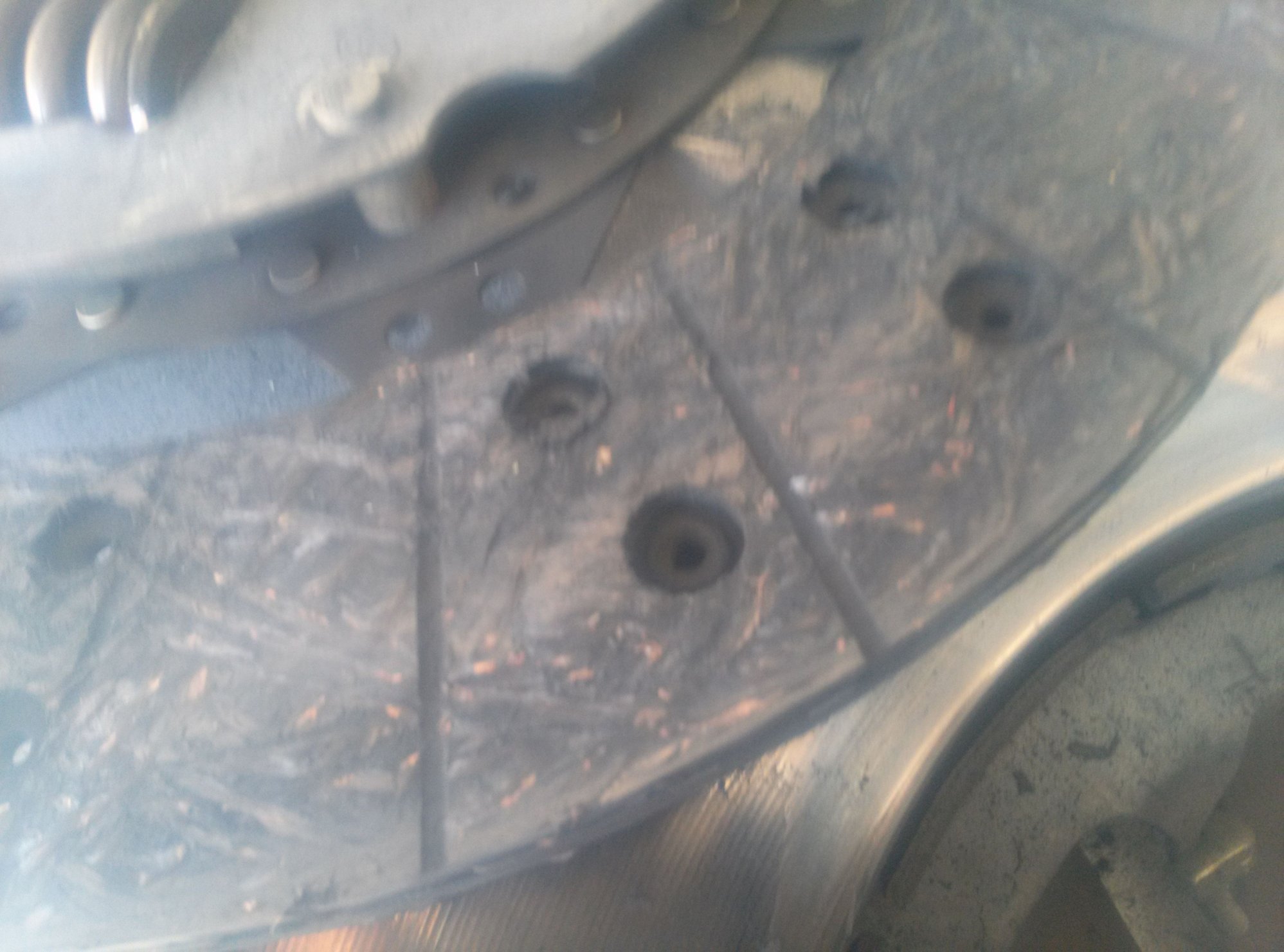

Well I did it. I got the cradle dropped and pulled out the old clutch and pilot bearing. I still need to put all the new parts on. It wasnt all that bad, plus I learned something. Im glad I chose to do it.
Gonna have to do some reading up on removing the tank to put in a Walbro 450 fuel pump I got. Figured Id throw one in while I have it all apart.
The factory clutch did not like the supercharger.

Nice job! Looks real familiar, mines apart in the garage for the same thing. Let us know how the mantic install goes, I'm about to pull the trigger on one. Would love to hear some feedback when you get it together.
