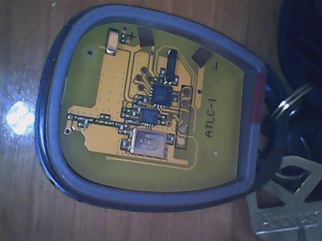

My FOB is evdently a newer circuit board layout - the parts are all much smaller and of course the layout is different from what is shown in the link. Even when I was working with this kind of stuuf for a living, parts as small as the ones in my FOB were very difficult to work on with a conventional soldering iron, regardless of tip size.

I am delighted that you show that much interest. Tomorrow, I will try to get a picture. I suspect that GM kept the same p/n because the fit/form/function of the FOB remained unchanged even though the evolving supply chain drove a new layout for the printed circuit board as time passed.

A picture would be nice. Does it no longer have the small IC chip shown at the top right of the board? That's the main one for losing sync that needs soldering. It will be interesting to see the difference.

Here is a photo of the circuit in my FOB
Don't know if this worked, but here is my shot at it

Sorry, I've never seen a board like that.

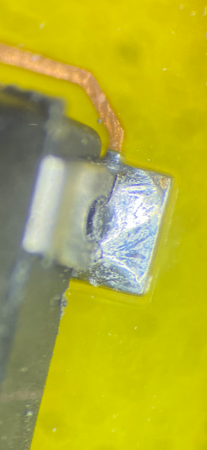

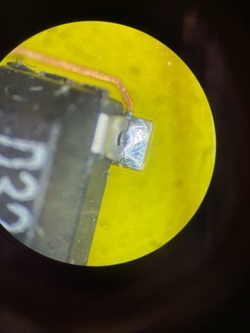

cracks on the board from pressing the lock key too many times, too hard.
