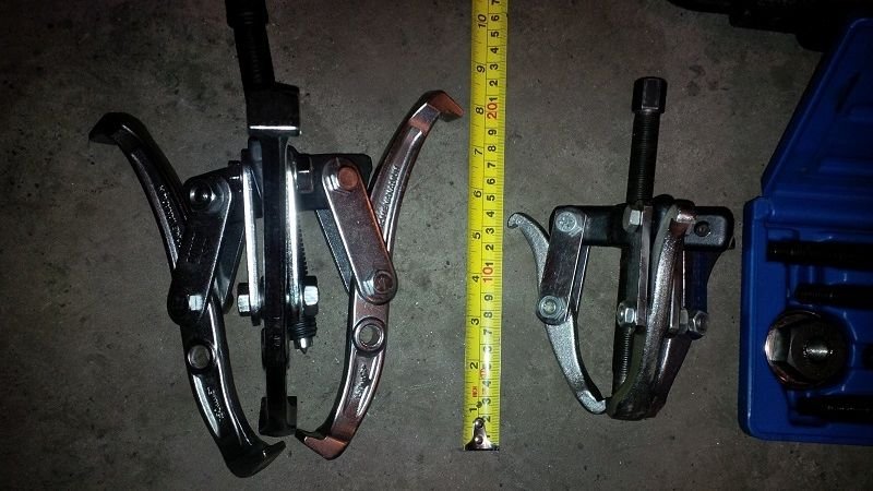

Will any of these pullers be sufficient for removing the pulley off of a C5?
Pullers
What about a pulley installer? Should I just make one with a m16 bolt with some nuts and washers?

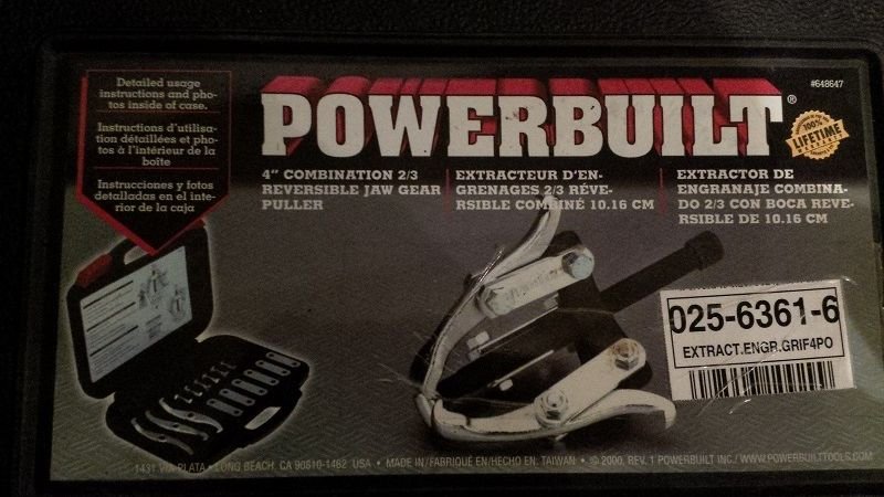

I had read that a 6 inches puller was ok to remove the balancer. I bought one but it was too big. Even assemble in the shorter configuration (left one on picture). I bought at 4 inch powerbuild part number 648647. It worked very well. A rod will be fine for the install. Make sure you have 16x2 thread. I did not want to take any chance. I bought the installer kit for around $40. I'm glad I had it. It required a quite some force to put new balancer back. I had heated the center of the new balancer with an heat gun to 150 degrees, but maybe not enough. I should have put it in the oven.

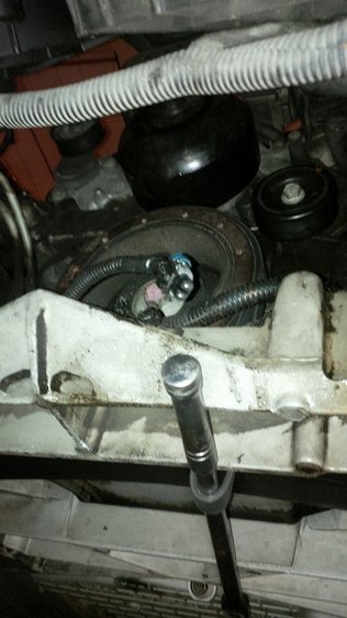

One more note. The flywheel locking tool I had ordered had not arrived yet when I started the job. I did not have the strap wrench Bill shows on the above picture. I could only find a plastic one. Guess what, I broke it right away. I had read a guy using the serpentine belt wrapped around the balancer held by the idler pulley. But I was afraid of breaking the idle pulley. I wrapped the serpentine belt around the balancer but instead of using the idler pulley, I use an ½ pry bar to hold it. It worked very well. See on picture. Flywheel locking tool arrived the next day and I used it to install the new balancer.
Awesome. Just what I was wondering.
