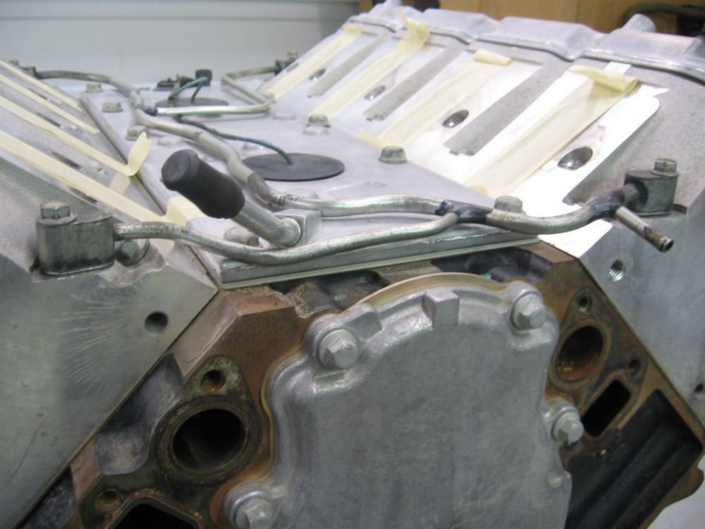

LS6 on a stock 2000 LS1. Tap the cross over lines down below the valley cover bolts and slap it on with new intake gaskets O rings
Difference between LS1 and 2004+/LS6 intake manifold:
LS6/2001+
97-2000 Intake:
There you have it!!

Default Question for Bill Curlee
Your comment "tap the crossover lines down below..." for installation of LS6 intake, are you referring to water or electrical lines? Please elaborate, thank you

I believe he is refering to the "steam lines" from the heads that connect by hard line in the valley

Part of the cooling system on the LS1

EXACTLY! If you remove the O rings fron the intake runners, and lay the manifold inplace, it should sit FLAT on the head surface and NOT rock. If it has a lot of gaps or teeter- totters in place,, it hitting on something that it shouldnt and the steam lines need more massaging or the small ribs under the manifold need to be ground flat.
If the steem lines are pushed down below the heads of the valley bolts you should be good to go.
