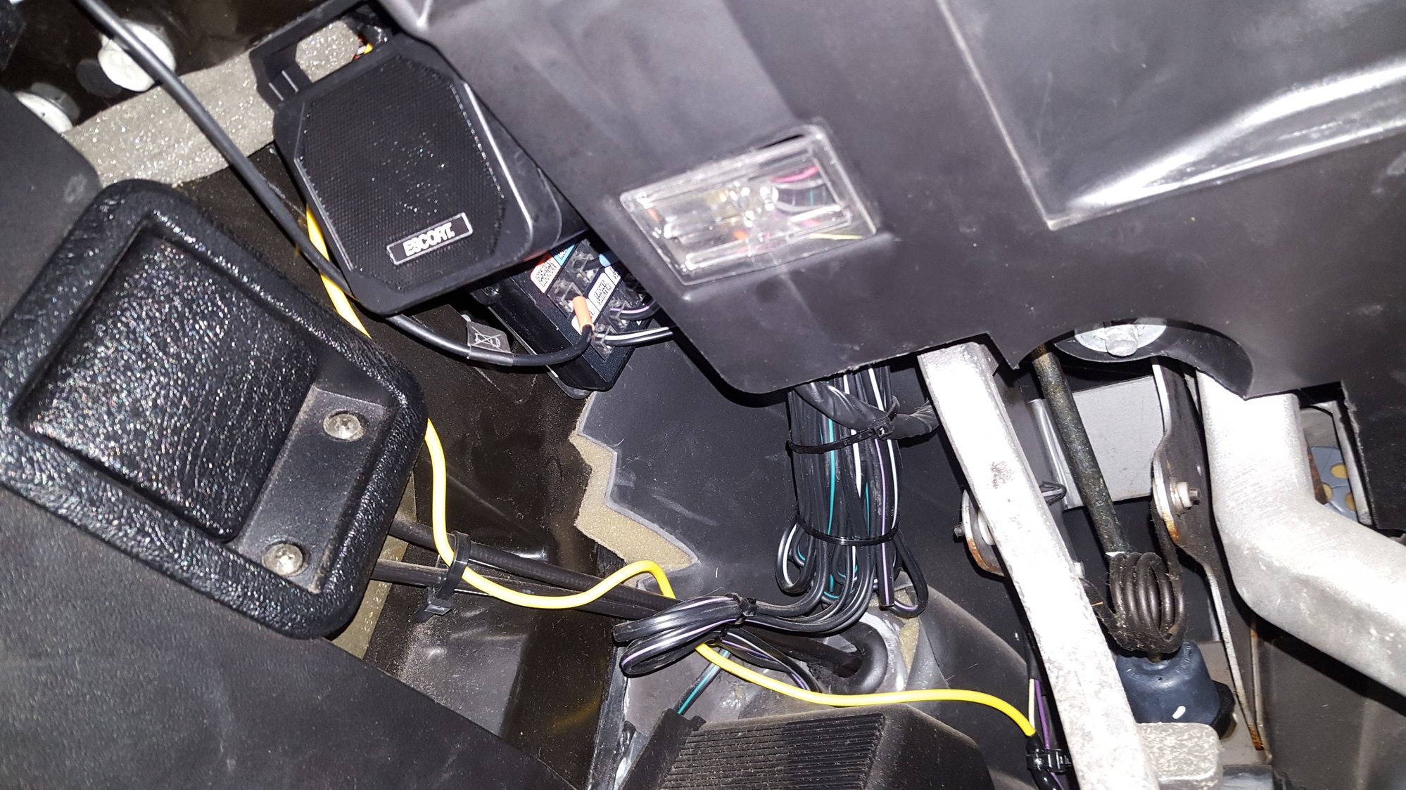

And a picture under the drivers area...

Yupp... that's a Compustar remote starter. Obviously with installation issues.
You can try to fix it or strip it. My Calgary offer is always open, it's almost spring here was 13 degrees the other day

If you can drop the cover panel under the dash and got a shot of whats there. Not alot of room to hide anything under there so the aftermarket stuff should stand out.
