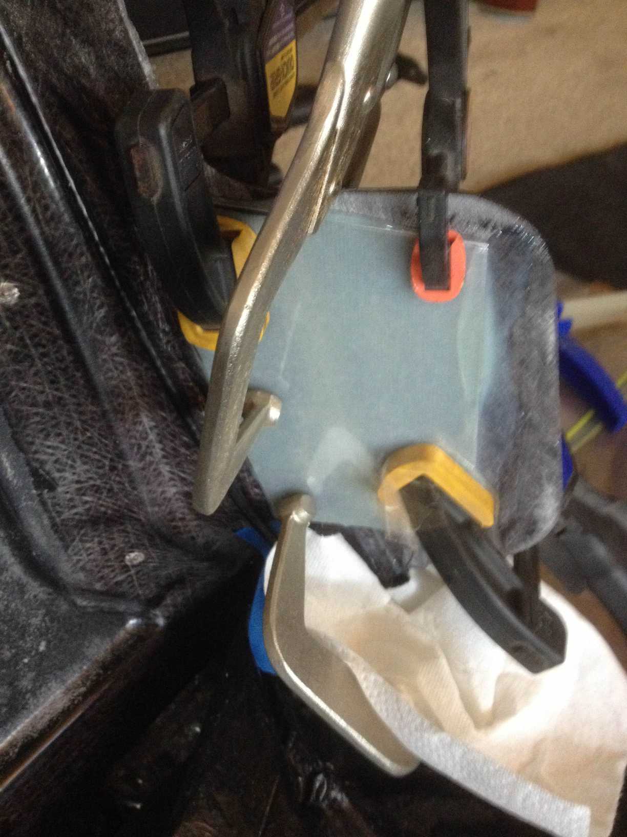

Sat down to recover my seats last weekend, and irony of ironies - I just had to make this very repair on the driver's seat of my own FRC. There was a small cut in the cover and foam by the lumbar support when I bought the car, and I always assumed it was from a sharp edge on the corner of the lumbar extension...Nope...
I bought new foam, including the heavy duty lower foam AND the base reinforcement kit (not needed with the DJM foam, so installed it on passenger seat), and was in a rush to install my new seat covers so decided to use some 1/16" thick G10 fiberglass sheet I had lying around. After scuffing the seat and the back of the G10 with 60 grit and cleaning well, I used some aircraft grade Loctite epoxy to glue the reinforcement piece in place with plenty of clamps.
After a couple hours of cure, I added some slit 3/16" ID fuel tubing reinforcement, duct taped well all around the edge of the lumbar support, and re-assembled everything. There is no way it will break again, the seat back is going to go first.
Wa-la, at the end of the day, redone seats (apologies for crappy pic):
Not a difficult project, and another method for quickly repairing broken seats. You can get the G110 and Loctite (ask for 1 hour cure) at McMaster-Carr for under $20.
Barry
