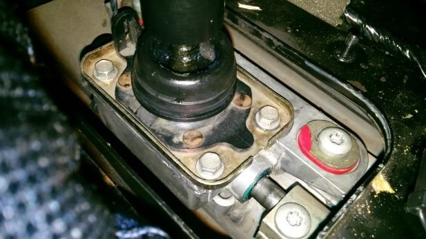

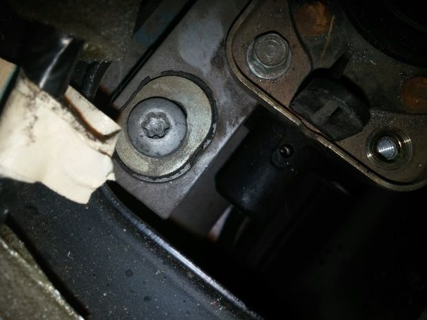

I went through the exact same procedure about a month ago. Here are some general notes from my experience:
* Note: These are the steps that I took, based on the research I did (mostly on this forum). If any of my comments are incorrect, please make note of it. *
Before pic. Note the deteriorated rubber bushing and the overall grime and dirt that is coating everything. You can also see the alignment port where the pin usually goes. The two holes should line up perfectly using a 9/64" drill bit. (I think that's the right size)
After: Everything has been cleaned and lubed. The old rubber bushings have been removed and the reddish polyurethane bushings are in it's place. There is a crack in the metal above the bushing. I couldn't find a replacement and don't think it should affect anything. But if anyone thinks otherwise, let me know.
- If your bushings are bad, you need to replace them. They cost about $20-25 shipped to your front door. I purchased polyurethane ones.
- For $50-70 you can get a C5 Z06 shifter assembly (upper & lower), which comes with metal bushings that don't degrade.
- There were complaints from Z06 owners that the metal bushings were causing excessive vibration through the shift lever, and GM eventually changed the Z06 bushing to some type of rubbery material (not sure which one specifically).
- The Z06 shifter is very similar to the C5 shifter, but is slightly shorter, so you get a little bit of that short shift feeling, while still having the stock smoothness. Or am I thinking of the C6 Z06 shifter???
- I dremmeled my alignment pin off as it was corroded. The pin is NOT 1/8". I believe it's actually 9/64". I used my drill set to find the bit that matched the pin. The reason it matters is that a tiny change in the alignment can make a significant change in drivability. By the pin being off by just a little bit, I was popping out of 1st gear violently a couple of times every drive. Scared the crap out of me...
- When aligning the pin, make sure it sticks straight up as you are tightening the Torx 40 screws. Keep adjusting the shifter and watch the pin as you tighten little by little.
- The (3) Torx 40 screws need to be tightened to 22 ft-lbs. Use a torque wrench or rent one from Auto Zone/O'Reileys.
- Smooth shifting does not come standard with a used car purchase. You have to keep playing around with it until it is to your liking. I had to open her up 3 times, adjusting and readjusting before it felt right to me.
- Once you're down there, you might as well open her up all the way. Remove the upper and lower shifter housings, disassemble everything and clean and grease the moving parts.
- You might have to use a screwdriver to gently pry the upper and lower housings apart. Once you do, the gasket is useless. Scrape it off and use liquid gasket sealer to reseal it when you're done with the cleaning and lubing.
- I used brake cleaner on the metal parts, but not around any of the rubber. For those areas, I sprayed brake cleaner on a rag and cleaned it that way.
- I used synthetic caliper grease to lube everything that moves. The difference was extraordinary. When I first got my FRC, I watched videos of people shifting quickly and thought that it would be impossible for me to do that. Once I cleaned and greased everything, it became easy as pie to run up and down the gears. The grime that builds up really messes with the speed of the shift.
- I think that servicing the stock shifter should be attempted before purchasing a new short shifter. You might as well get to know the process, and you might be happy with the results.
