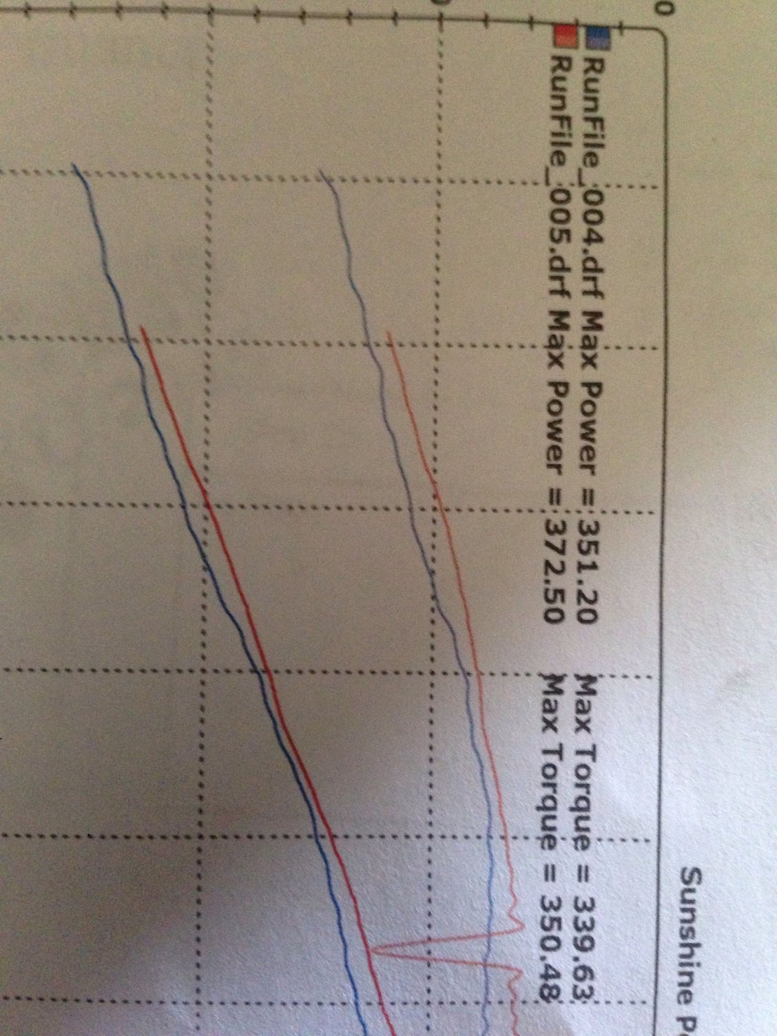

Before they put it on the dyno they went over the entire engine, and drivetrain. I ask about O2 sensors when I dropped it off, and he said that they would be able to tell if it's an O2 sensor, and any problem they find they will let me know about before they start adjusting the tune. About 10 minutes ago, he called and said the car has something's that need attention like a small oil leak, but that it definitely wasn't tuned correctly, and the first dyno test put 351rwhp, and he would be able to get more out of it. I will update everyone when I get the car back. I don't think he would adjust the tune to hide issues when finding issues would possibly lead to more money for the shop, but maybe. I also want to say thanks to everyone that has taken time to help troubleshoot. Especially Bill.

Good news is 372 rwhp. The bad news is they told me whoever installed the cam did a horrible job with the seals, and I need to get them fixed, as well as a water pump leak. Also I need new plugs and wires. Max mph they hit was 192.
