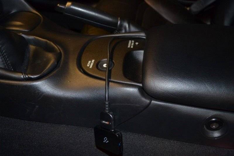

Do you have the 12 disc CD Changer in the back? And how much of an audiophile are you? On a scale of 1 to 10... 10 having a 15" sub and 1000 watts of amp to power a full on ear blasting crystal clear system... or 1 being the stock Bose system...
I play guitar and I'm pretty pick about the quality of music so, the factory Bose system was NOT acceptable... I called Dennis and upgraded the factory speakers... then added the Peripheral PXDP PXHGM2 Chevrolet Corvette 97-04 iPod Adapter KIT, I also bought an Aluratek 30 Pin Bluetooth Audio Receiver for iPhone Dock
So, now I have lots of options for good clear music to play through my factory head unit... it's probably a 3 or 4...maybe even a 5, it really cleaned up the sound, could use some more bass, and I need to do some sound deadning in the rear of the car... I think that will help...but, for the MONEY I am satisfied with the results.
I listen to ALL kinds of music so the factory preset EQ's help with each song to bring out what I am listening for...
Inside the console
Or if you want to plug in the Ipod and or another device you can run the cable under the lid of the console...
