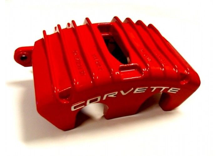

After painting my calipers, should I use sandpaper to bring back corvette lettering?

It worked great for me. Just use a small block to keep the paper flat so you only sand the letters and not scratch the rest of the caliper.

I used a razor knife and cut the paint away. I would recommend doing it as soon as you can safely handle them, while paint is soft. I used VHT high heat caliper paint. Good luck

sanded mine too, used John Deere Muffler paint...AWESOME stuff!

Just get them powder coated... looks great and will last forever.. we have them for $329

Yes we rebuild the calipers with new seals and boots. We don't replace the pistons but make sure their in great shape... We can do them any color but trying to get a perfect match to metallic colors is hard.
Painting calipers can work well BUT it's ALL in the prep... need to make sure the surface is nice and clean so the paint will stick. Most paint if used on a daily driver will eventually deteriorate.

After the calipers are powder coated the letters are then sanded.

I used an emery board to sand the letters down. You know, the ones for your finger nails.

I painted mine for now until I get them powder coated. Used a fine metal file for the letters
