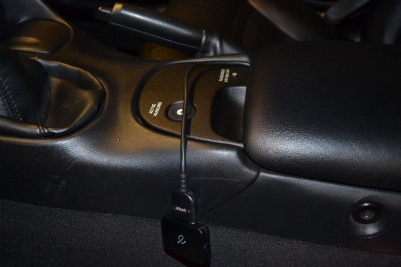

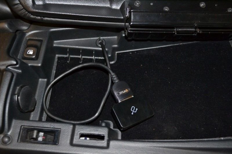

The Bose system with the CD's sounds pretty good... if, you'll upgrade your speakers to almost any aftermarkets it will sound MUCH better... Dennis at Double D mods sells some upgrade kits... they are plug and play....I did the Kickers because I live close to the factory and like supporting them.... but, I would have gone with the Alpine if it hadn't been for my loyalty to Kicker.
Also like Sam said, the Ipod adapter and the Bluetooth receiver are also VERY nice upgrades....still looks stock if you do it right...here are pics of mine installed..
I just leave the Bluetooth receiver in the console... it plays great... Pandora, My song list, Ipod, or whatever it's awesome!
