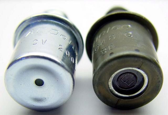

02 Z06, do I replace mine with a standard pcv valve with check valve or the fixed orifice one?

You can use either. Some say that the fixed hole helps reduce PCV oil pull over.
The system really needs a CATCH CAN to reduce oil in the manifold. The one that came with your car is the one with the spring controlled valve..

When I rebuilt my motor this spring I replaced mine with the fixed orifice one. I have about 2500 miles on the engine and I just pulled the throttle valve off and checked out what the inside of the manifold looked like. I did not appear to have a large amount of oil getting into the manifold. Hope this helps. I did have a hard time finding the fixed valve locally, finally found a chevy dealer that had some old stock.

Neither. Do a good catch can like the one from mighty mouse. The small ones sold Here are worthless
