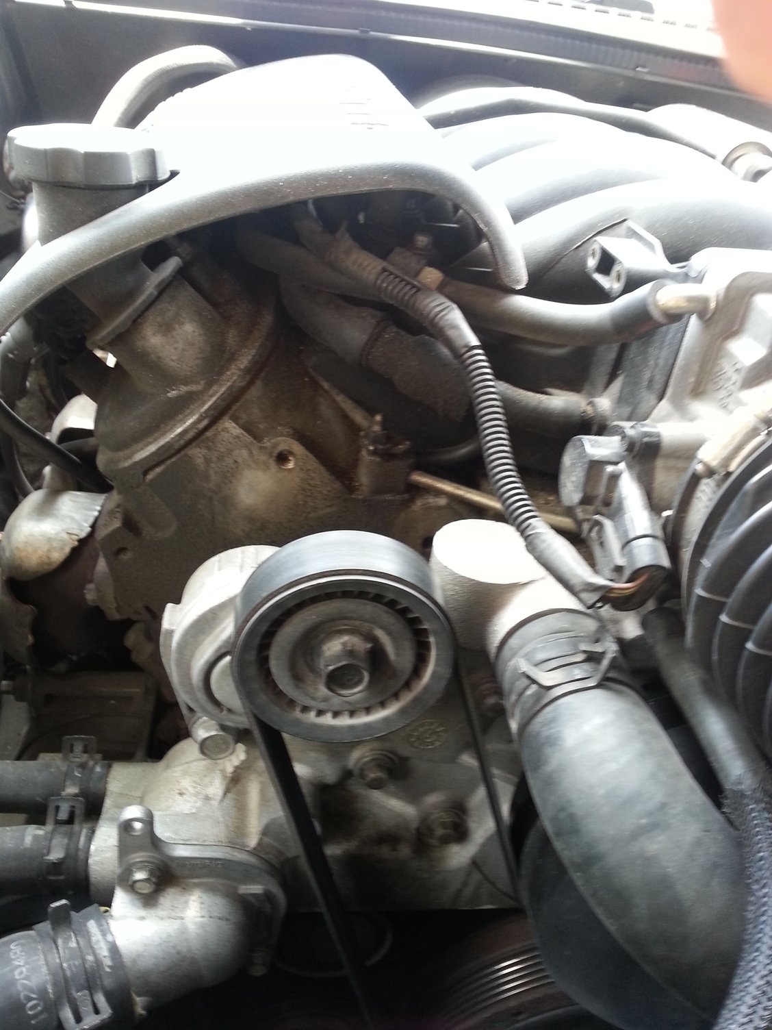

Are we talking about the tensioner on the passenger side of the engine, right on top? Mines has a bit of a lean to it.
Played with the car a bit. The volts rise and fall with the engine rpms. Idling it stays around 12.0-12.2 rises with rpm and then stays steady at 13.7 anything over 2000rpm

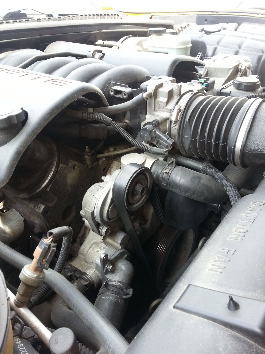

Old Aug 26, 2015 | 03:00 PM
CamoCJ5's Avatar
CamoCJ5
Joined: Dec 2013
Posts: 25
From: South Carolina
Pics of the pulleys
