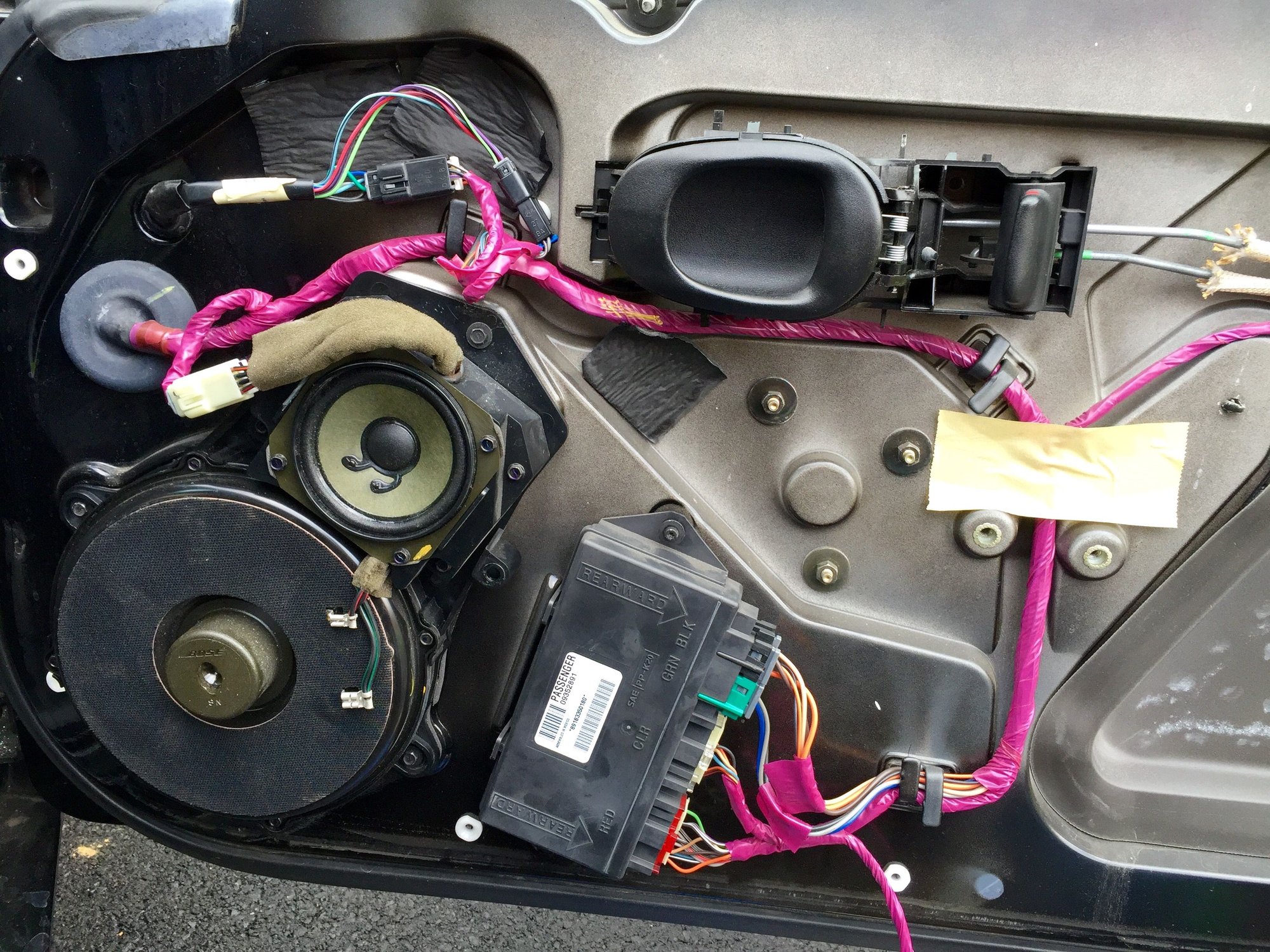

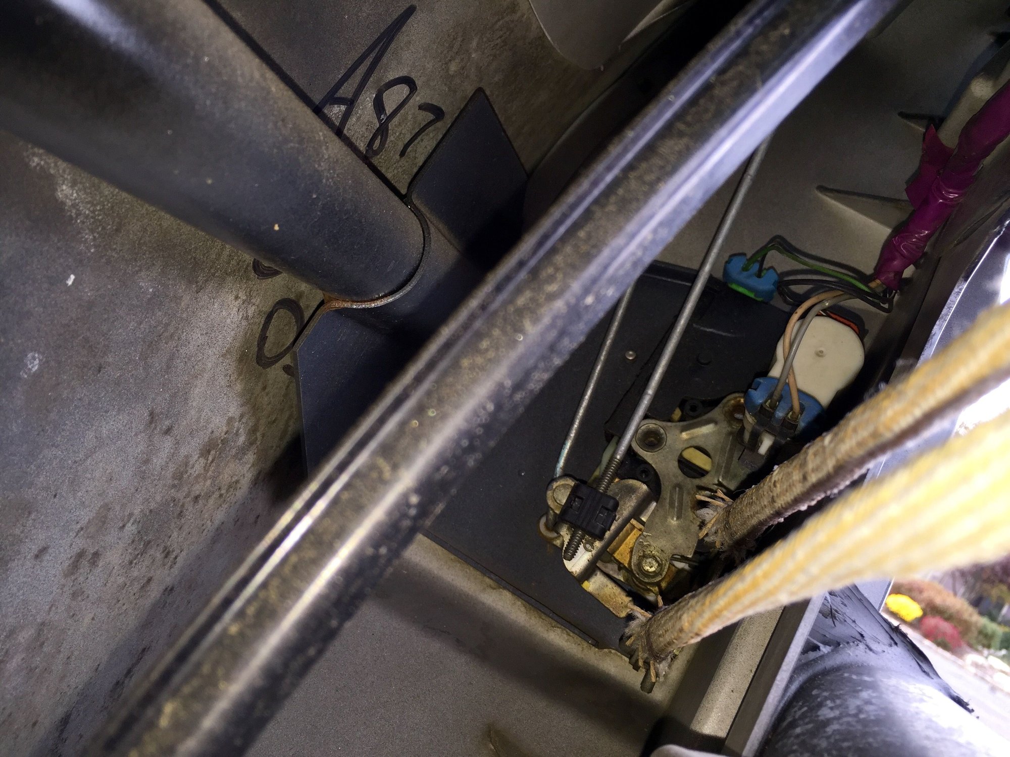

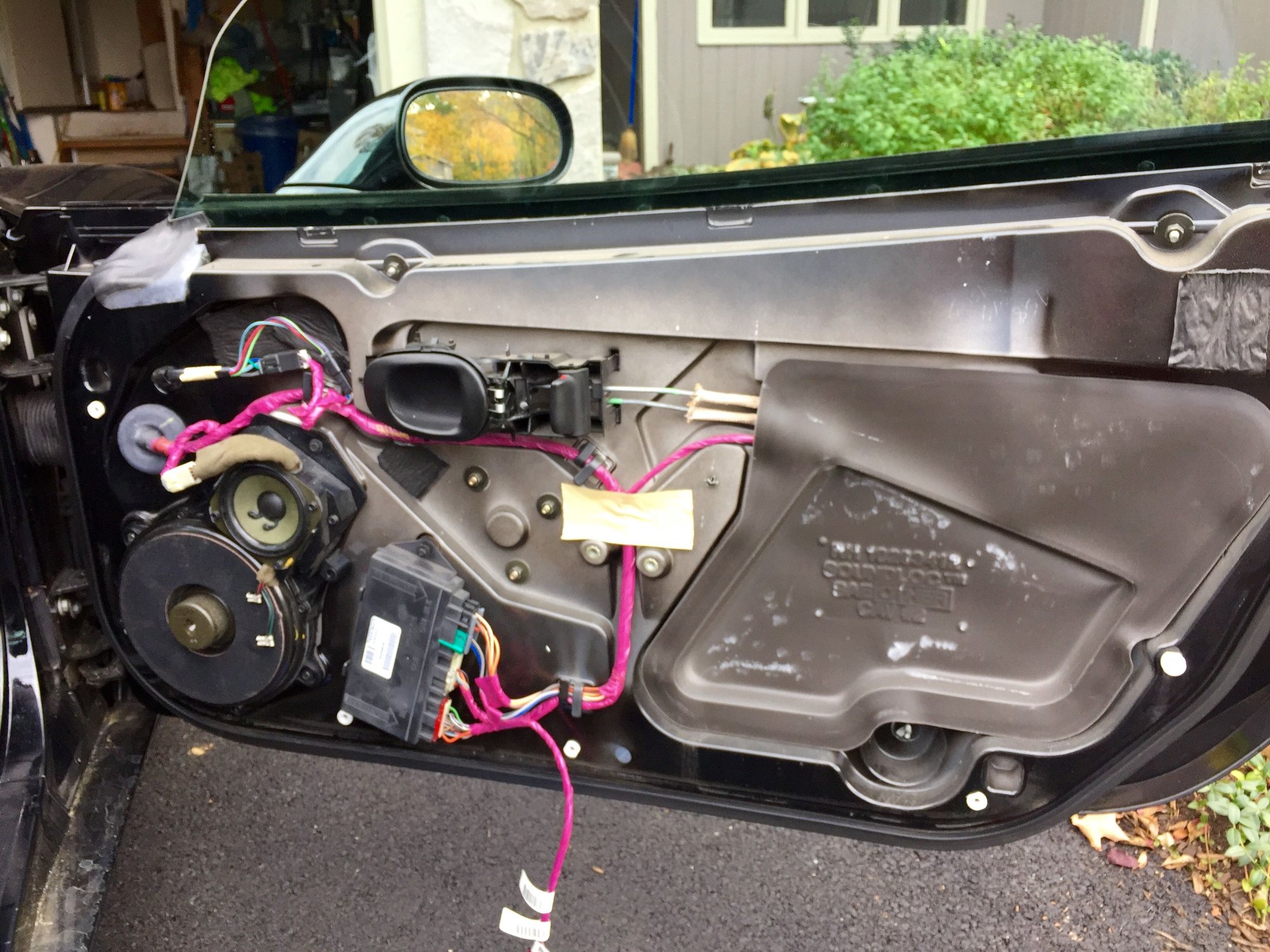

Thanks. This is where I've gotten so far. Replaced fuses for HVAC (no beans) replaced fuses 31-32 (I think) for the left door controls, no beans.
Now I took the door off, made sure the connectors were good, hit them with electrical contact cleaner, and still nothing. Had to reprogram my key after too.
This is what I'm looking at. Please let me know your thoughts, thanks.

Old Oct 22, 2015 | 02:20 PM
Csalads09's Avatar
Csalads09
Joined: Oct 2015
Posts: 61
Likes: 15
Behind the rubber
You hear a clicking noise from the DCM but zero effect on the door lock
