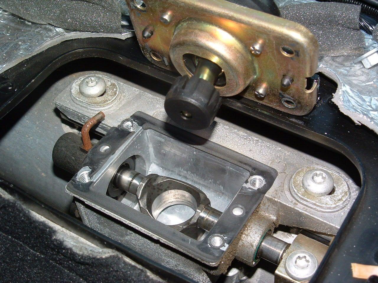

You can see the star bit bolt that connects the shifter rod to the rod that goes to the tranmission at the back of the lower box... YOURS might be completely loose... which would NOT let you shift... because it's just rotating on the shaft.

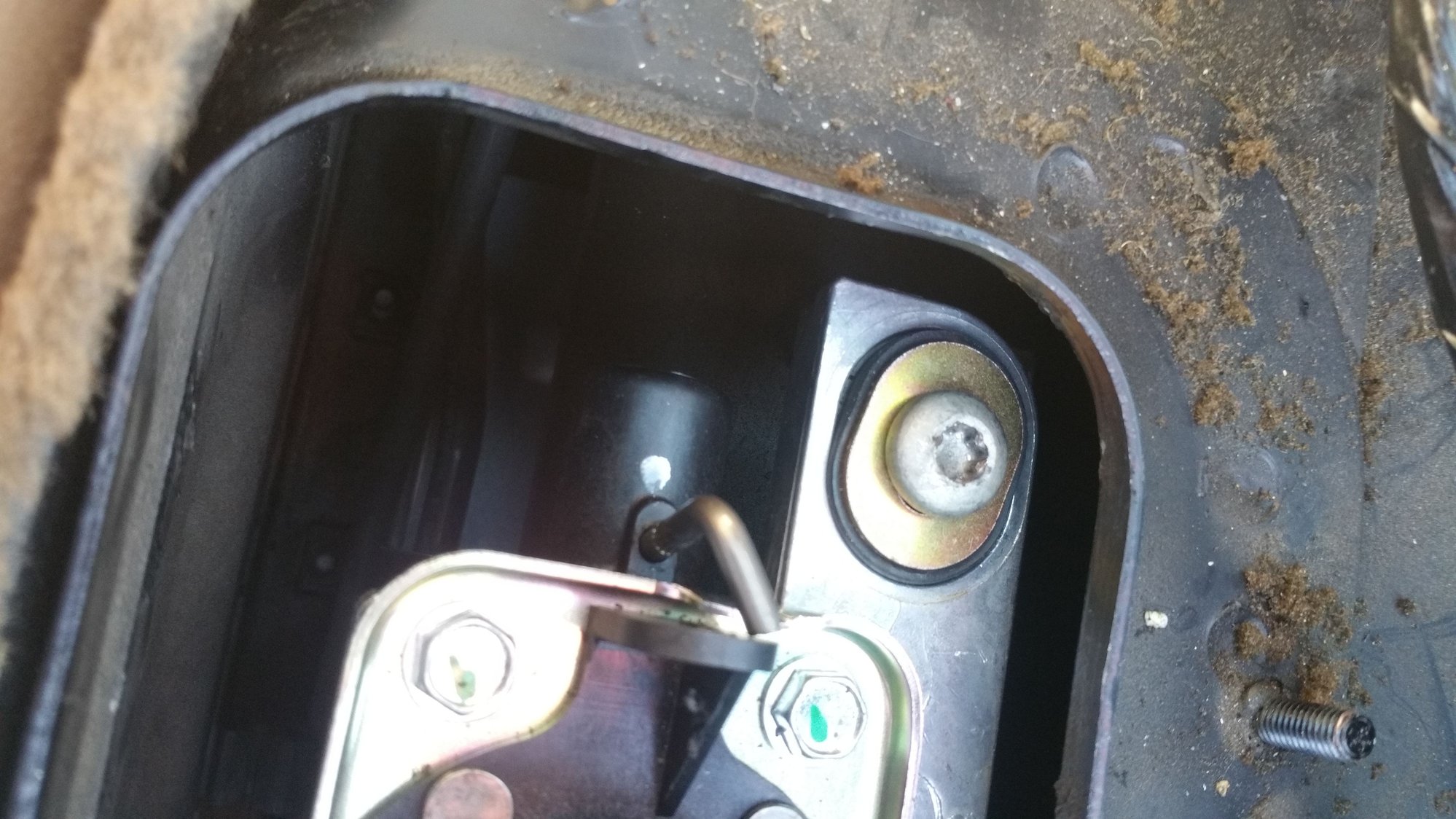

Old Nov 8, 2015 | 09:15 AM

ok i fixed it, it was the pin that prevent your shifter from going into gear, i forgot to remove it completely during the installation, it just fell in place that night and locked the shifter.

That is an alignment pin, to insure that the shifter is in the neutral position when installing the shifter... you can remove the pin after you have installed/adjusted your shifter so that can't happen...
Glad you found it and got it fixed
