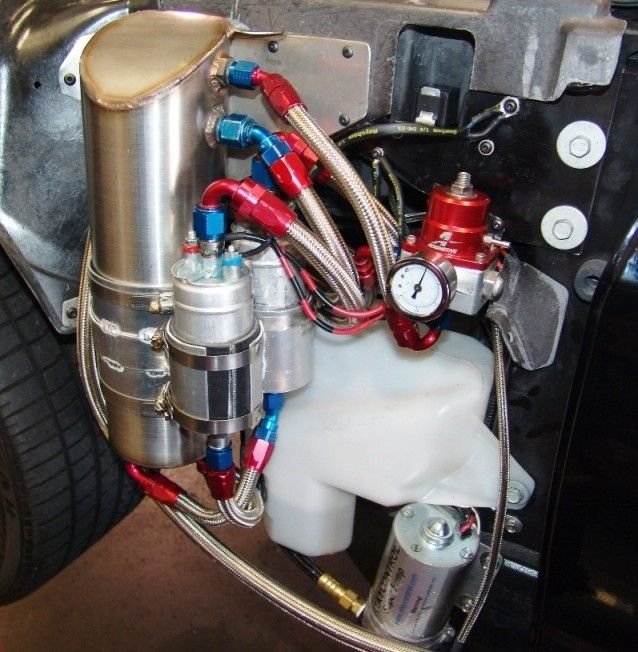

Originally Posted by c5maniac2
It's a 2004 twin turbo Z06 making 800+whp. Constantly having issues with the siphon jet system so I'd like to do away with it. I have no issue customizing the tanks, I just want to make sure I'm not over looking something and creating another problem. As long as the gauge reads correctly with both fuel level senders staying equal I think I should be good no?
You will have to do more than that.
That is why we did the fuel system the way we did on big power cars.
https://www.lgmotorsports.com/corvet...el-system.html
You would find almost that entire assembly inside of the fuel cell in the ALMS car pictured above. Running fuel cells in a normal street car however is a bit more costly than just adding in the fuel system like we did.
This is roughly what it looks like inside.
While a cross over at the bottom would help, it wouldn't solve it all.

Is NASA missing some engine pump parts? Very impressive to say the least.
Mr. Sam
Of course each one of those has multi pumps for different reasons.
On the kit we sell the stock pump feeds the bigger tank which in turn supplies fuel to one of the Bosch pumps, the second Bosch is powered up when the car sees boost and you have both of them running.
On the ALMS car it actually had four pumps. A lift, or supply, pump that fed a separate chamber in the cell (reserve) which overflowed into another chamber (main) that each one of the Bosch pumps pulled from. So the car would run off the main pump until it was on fumes to which the driver switched to reserve and pulled from all four pumps at once to make it back to the pits if you were dragging a pit stop out for more than you thought.
Either way...yes to do the fuel system in these cars correctly for big power or for racing takes a bit of work, more so than just changing the fuel pump in the tank.
