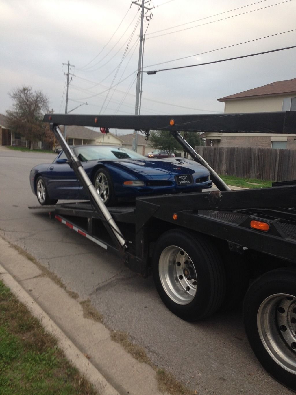

And here she is being delivered to my house...

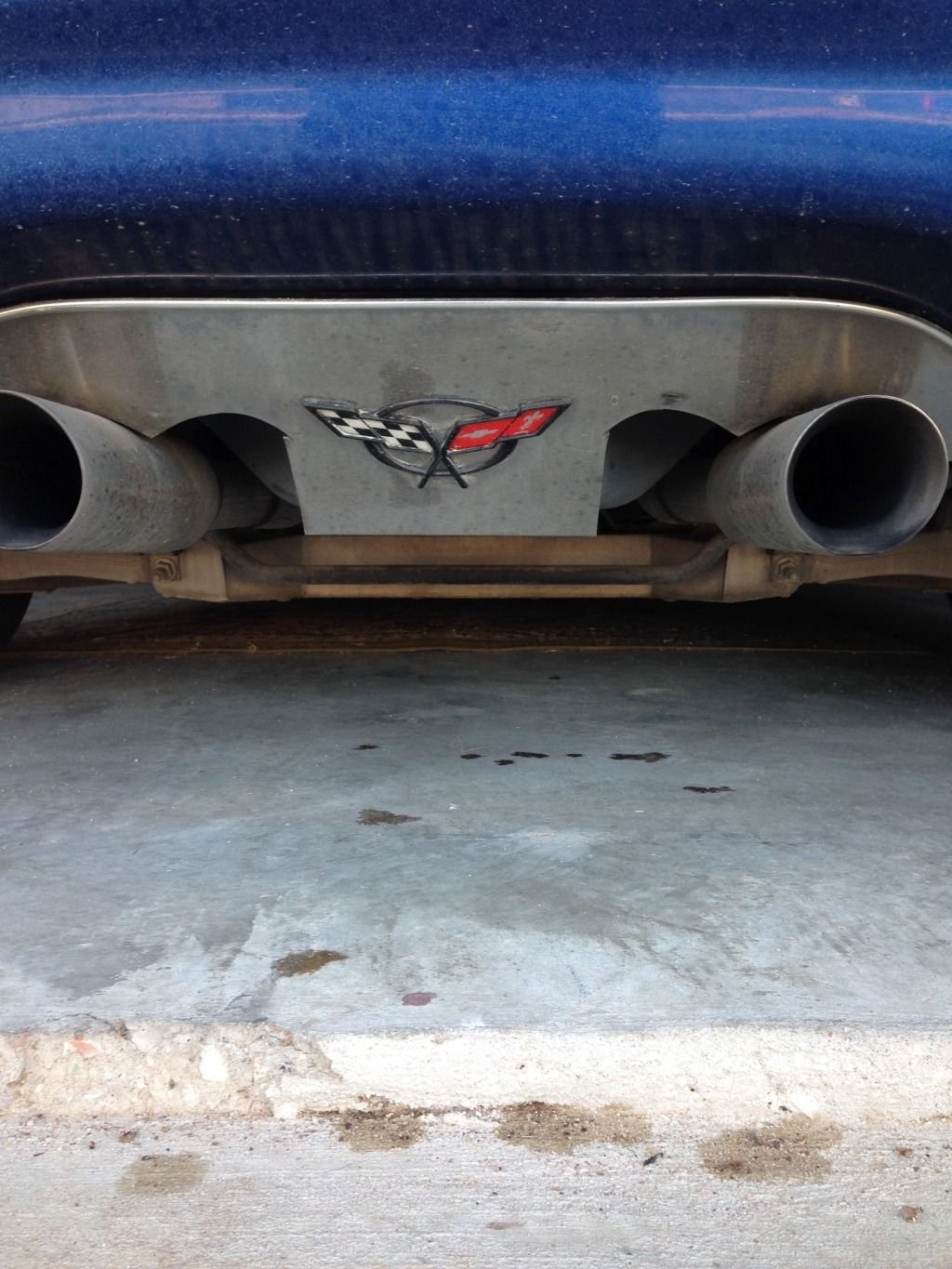

Pics show modified or aftermarket exhaust.

Car obviously (pictures) has an aftermarket cat back exhaust so perhaps you are not familiar with what a truely stock car came with???
LOL - I really am a novice. I don't even know what a Cat Back Exhaust is. Is that what makes this car so loud? When I start it in the garage, it shakes all the windows on the second floor of the house. Sounds like a gigantic Harley being revved up.

Yes, but that might only be part of it. No CATS and headers will be louder still.

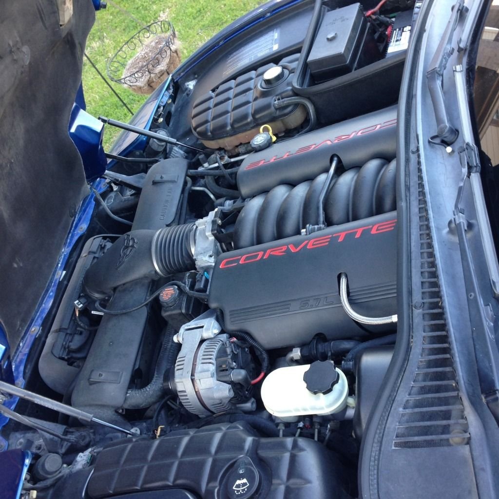

Can you shoot a photo of under the hood and under the car an post them? That might answer some questions for you.
