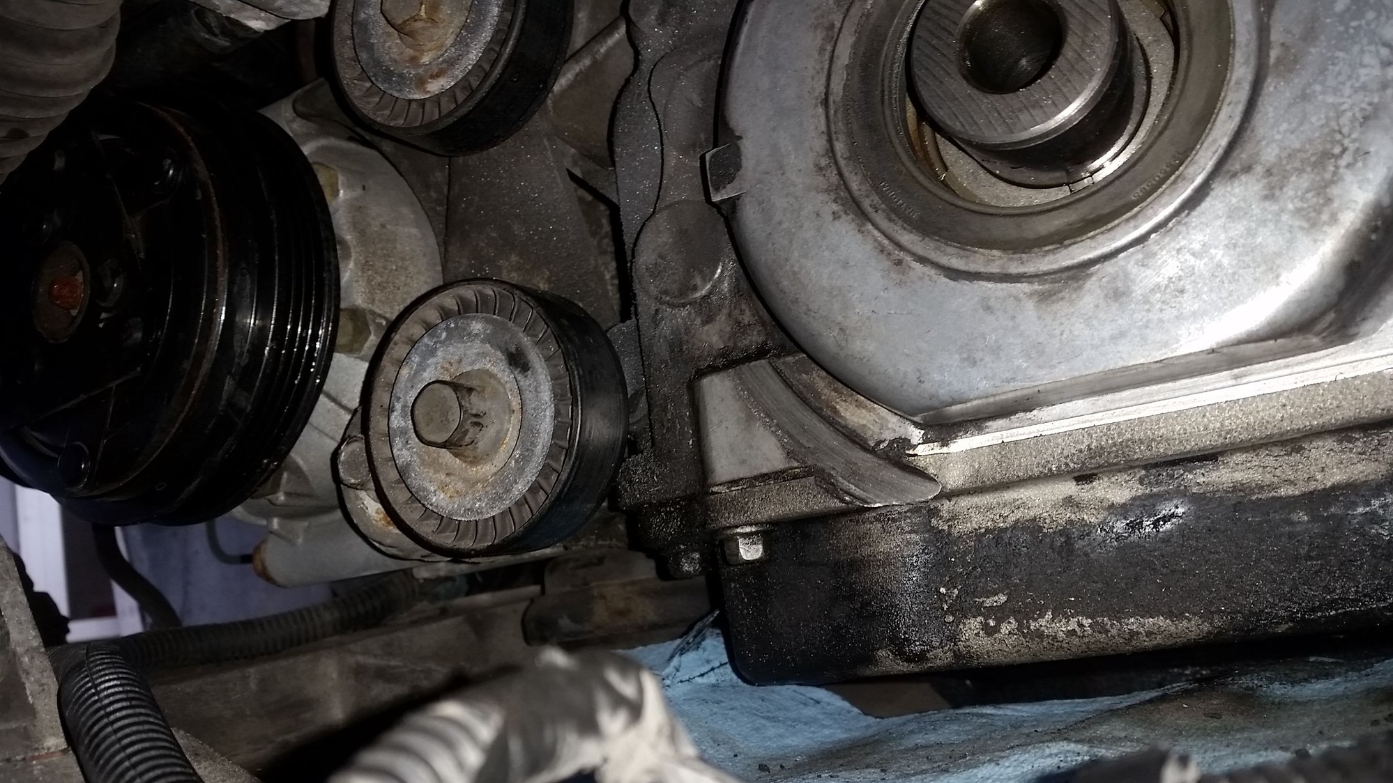

I just pulled my balancer tonight to assess the damage it caused when it ground into the timing cover. I have an oil leak from the front of the engine, and don't think it's the front seal.
Has anyone had this kind of damage before? Seems from the pictures I've looked at that both the timing cover and oil pan don't have alot of thickness where mine is damaged. If I'm this far already, I'd rather just pull the cover and see if I need to fix/replace it and/or the oil pan.
Here's a pic for reference:

I don't think your damage has caused a leak. Looks like you have had an issue long before that happened.

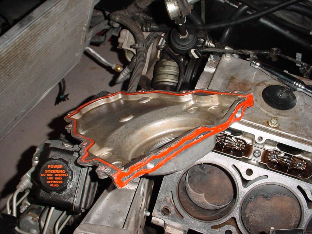

You can get an idea how thick the oil pan/cover flange is in this pic. Its the other side but they are pretty much the same.

Bill, that was my major concern on that side.

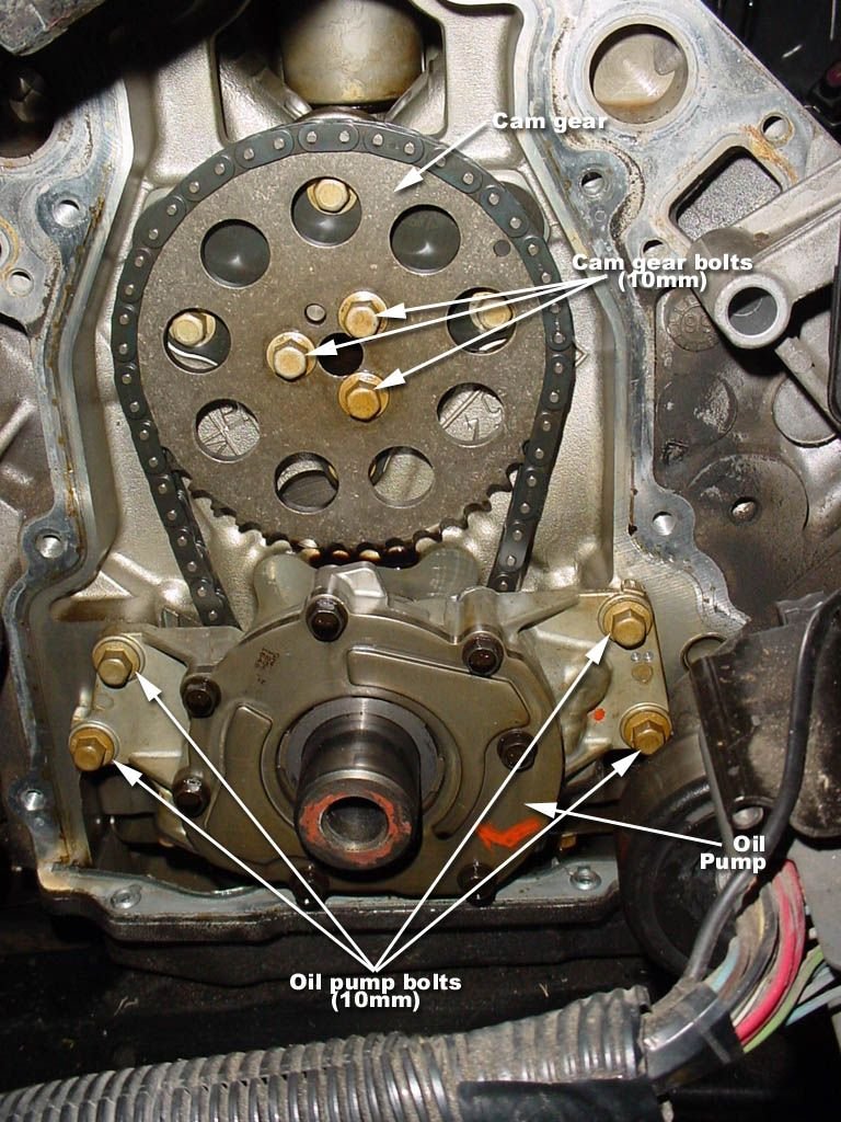

I looked at this pics on the LS1howto for removing the balancer and the following two pictures make me feel that the pan and timing cover are thing in that area.
I haven't had it apart and can't tell how close/far from that curved, thin area my damage is. I'm also only guesstimating on the depth of the groove, but mine does go back all the way to the end of the lip on the oil pan.
