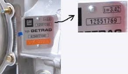

All good points. As far as I know the rear is what came stock with the car, which means I don't really know. It is a 4 speed Automatic w/od. Since it's garaged I can't take it out for a drive to determine the rear ratio. Depending on what route I went I may do my own wrenching, but if it's exhaust or rear I don't think I will mess with that. I like the header advice so it breathes a bit better and there would be money left over for a tune. Then if I go with gearing later I'll already have a good running engine.

Should be able to look up your axle ratio on the RPO. Mine was on one of the carpet covers in the trunk

There's a tag on the diff that has the ratio.
Or sticker in glove box.
2.73 ratio = GU2
3.15 ratio = G90 and/or G92 (sticker may show both)

If you have the 50th AE as you stated at the top and you have the A4, then you SHOULD have the 3.15 performance axle....
