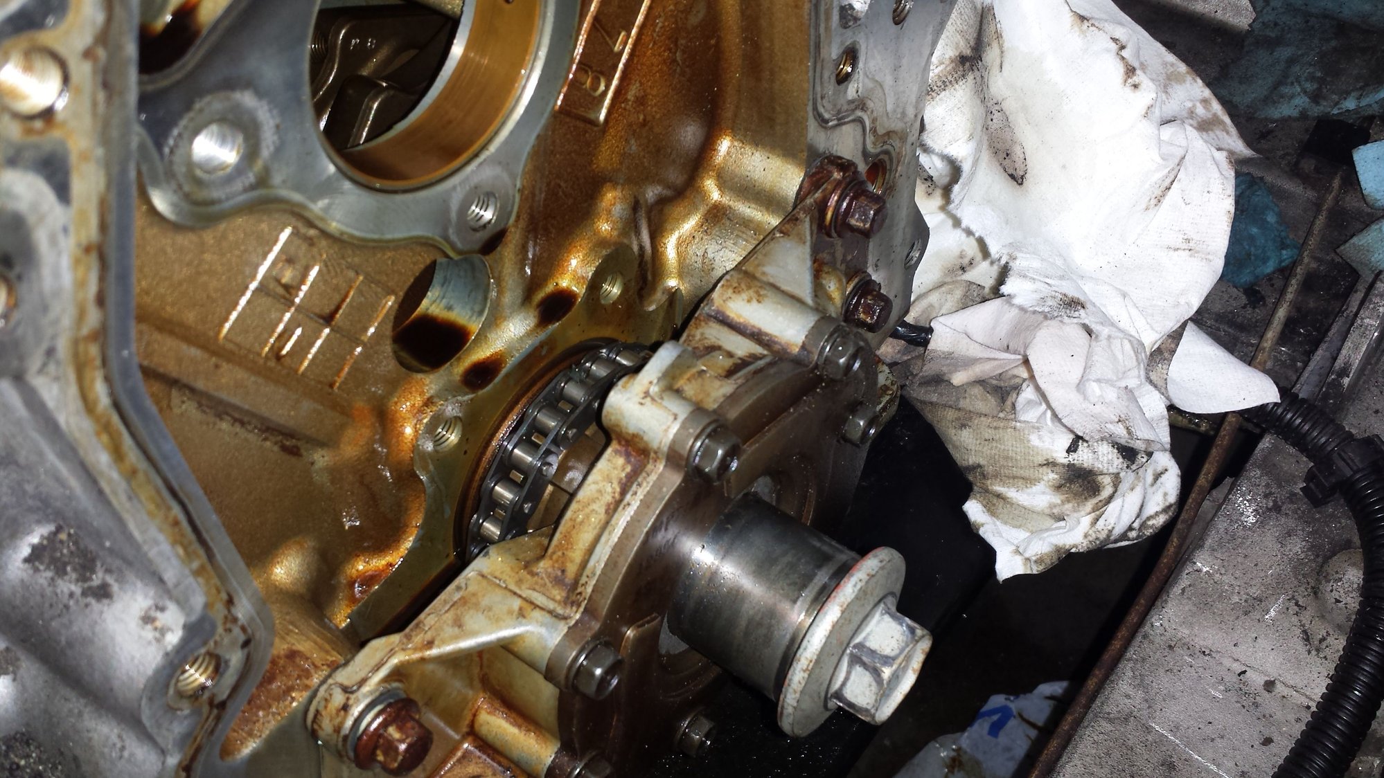

Hey folks- if you haven't known from my many posts I've been slowly pecking away at my heads/cam/intake/exhaust project
Cliff Notes Version:
206k mile car is disassembled down to short block. Considering my next move- as some things are concerning:
A) Just start reassembling the car, driving it until something catastrophic happens or starts burning ridiculous amounts of oil
B) Since I'm so far into it already- might as well pull the motor and refresh or replace the short block.
Long Version:
I'm at a crossroads- my car has 206k miles on it. My freshly ported, valve jobbed and machined 243 heads should arrive back from AI any day this week- so this means I'm ready to do reassembly after some more cleaning of the block. Looking into this- At first I was going to just start reassembly and start using it -
but a few things have me concerned:
1) My last Blackstone report last year read:
"We're seeing some high levels of aluminum and iron in this first sample from your Corvette. Aluminum is typically from pistons, with iron from steel parts like cylinders or shafts. Together, these metals
might point to some piston slapping or some other piston/cylinder wear. Have you been hearing any unusual noises from the engine? Neither metal is really cautionary at this point, especially considering your long oil run (averages are based on ~4,100 miles of oil use), so for now, just cut back to ~5,000 miles and check back to monitor trends. The trace of fuel is okay."
2) I may have screwed up and scotch brited the pistons and started to on the deck (by hand, NOT by tool). From what I read there are many differing opinions - some said it works well, others said big no since it introduces crap into the walls of the cylinder that will never come out . I used the blue supermarket kind- couldn't find an SDS so I'm not sure if it has aluminum oxide in it. Either way, I'd clean everything as best as I can and change the the oil several times at short intervals upon reassembly.
3) Since I have an earlier LS1 with the weaker rod bolts and thin cylinder walls- it's less desirable.
4) The cam bearings and the impossibility of getting to the rear one.
Any opinions on what you see here?
Thus- I'm now considering pulling the short block completely This will significantly extend the duration and the cost of this project but I'm wondering if I'm shooting myself in the foot by just reassembling the thing without pulling the block. Help!

Thanks for the replies everyone. After kicking this around here's what I'm going to do- the blackstone analysis was concerning. While nothing has catastrophically failed yet, I'll take out the block and send it to the local machine shop. For ~$150 they will disassemble, hot tank and clean it thoroughly and check the specs - which means I can stop scraping the damn graphite headgasket off the deck. Based on what they find, I'll get items replaced items as needed, refresh the rings, cam bearings, hone the cylinders (yes I'm aware it can only do .005"), upgrade the rod bolts, maybe get the rear oil galley cut etc. I know my early year/high mile block isn't the most desirable but at least I know it's out of a running car and don't plan on beating the crap out of it.
While I do miss the car- a few more weeks down really won't hurt me. I've got the insurance and satellite radio suspended too. My new goal is Easter to have everything done. In fact in the spring/summer time I'm usually riding my motorcycle anyway
While it's tempting to go all out with another block, I'm going to take one step at a time- first just experience the new 243 ported heads and cam, see how I like it. Once I get tired of that, then I'll take it to the next level.
This weekend my friend is going to bring over his cherry picker and help me pull the short block. I realize after this the block won't be honeable anymore if honed and I'll be doing certain things twice, but this should hold me over for several years. In 2 more years the car will qualify for historic plates too, so no more emissions and cheaper registration + insurance I'm also curious to see after owning the car for so long how well everything survived.
Then in the mean time I'll slowly search for another short block - either like to do a LS2 402 stroker, or build a smaller cube block for supercharger use, along with the C6Z driveline parts. Even if that build takes several years, I can do it on its side, wait for the best deal to show up etc. My last car I had the reverse problem- there was literally NOTHING available aftermarket. But for the LS's- there's so many ways to skin a cat, it's hard to decide and it's hard to resist "for only X more, you can upgrade/add ___ just in case you decide to do ___ later on...."
Thanks for the help everyone, it took almost a week of research and thinking on what to do. Anyone have other thoughts, definitely chime in!
