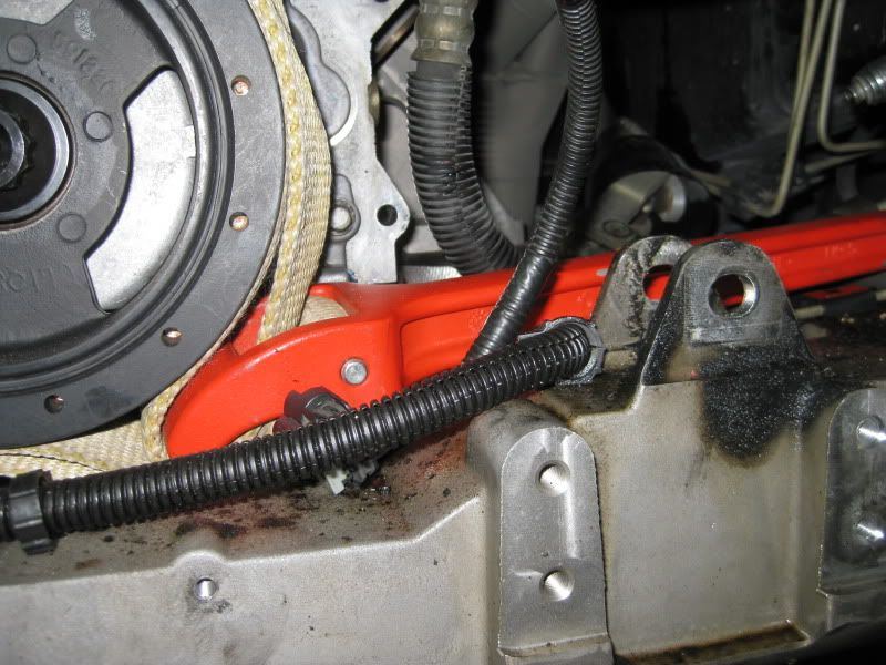

Here's a tip, find or rent a Ridgid Strap wrench. That way you can really lock the HB so you have a chance to get that 240 lbs on the new ARP bolt. The Hawks Balancer install tool is well worth the money.

What im trying to figure out is how do you get to that Tq rating without the Balancer moving out of the correct position (too far back) on the front seal housing. Never been able to get to 240lbs.
Look at this link
https://www.corvetteforum.com/forums...post1591521561

I actually bought one of those right after I posted in that thread. That wouldnt help with what im saying though. What im sayng is...you get the balancer to the correct depth on the crank (I actually marked it on the Front seal housing so I dont have to measuer anymore. But then when you wanna tq it to spec. When you go to tq the balancer it just goes deeper when you tighten it.
