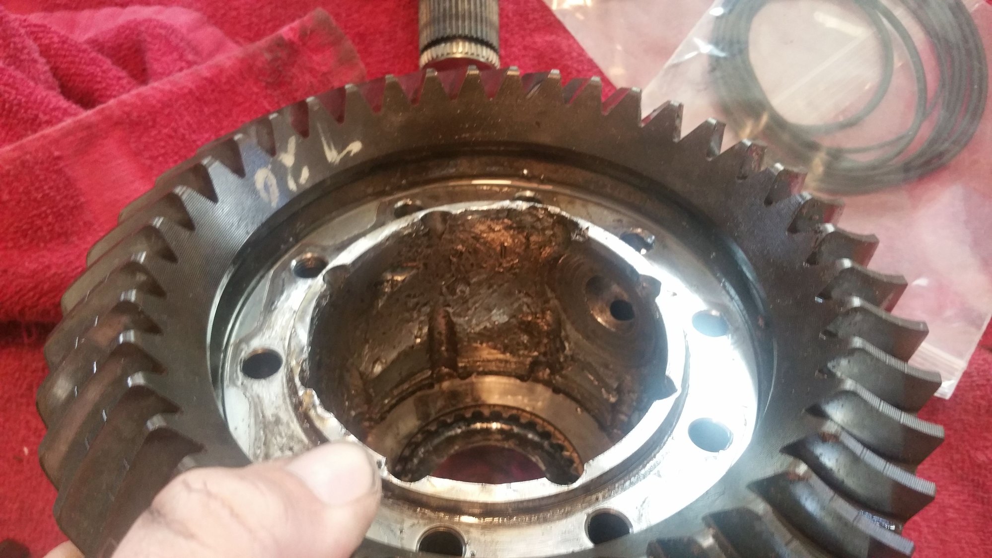

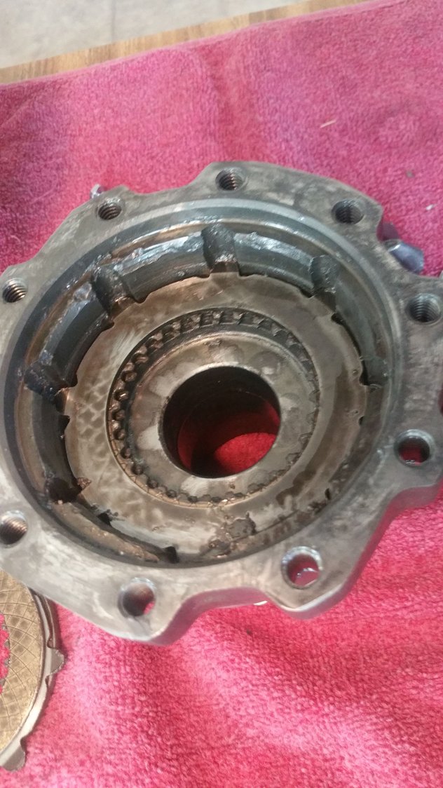

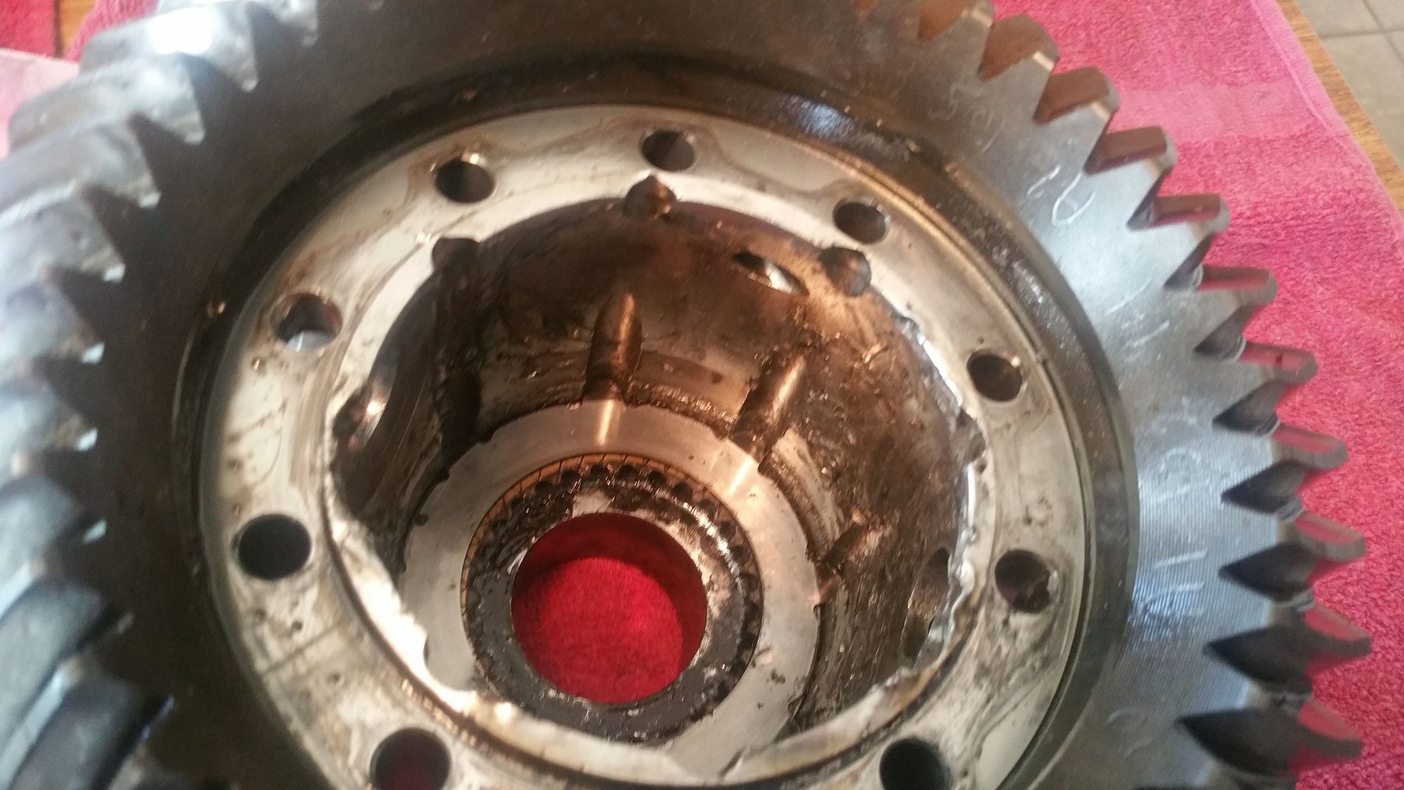

Diff started making noise so i ordered c6Z06 shafts and clutches.
Opened the posi and this is what i got.

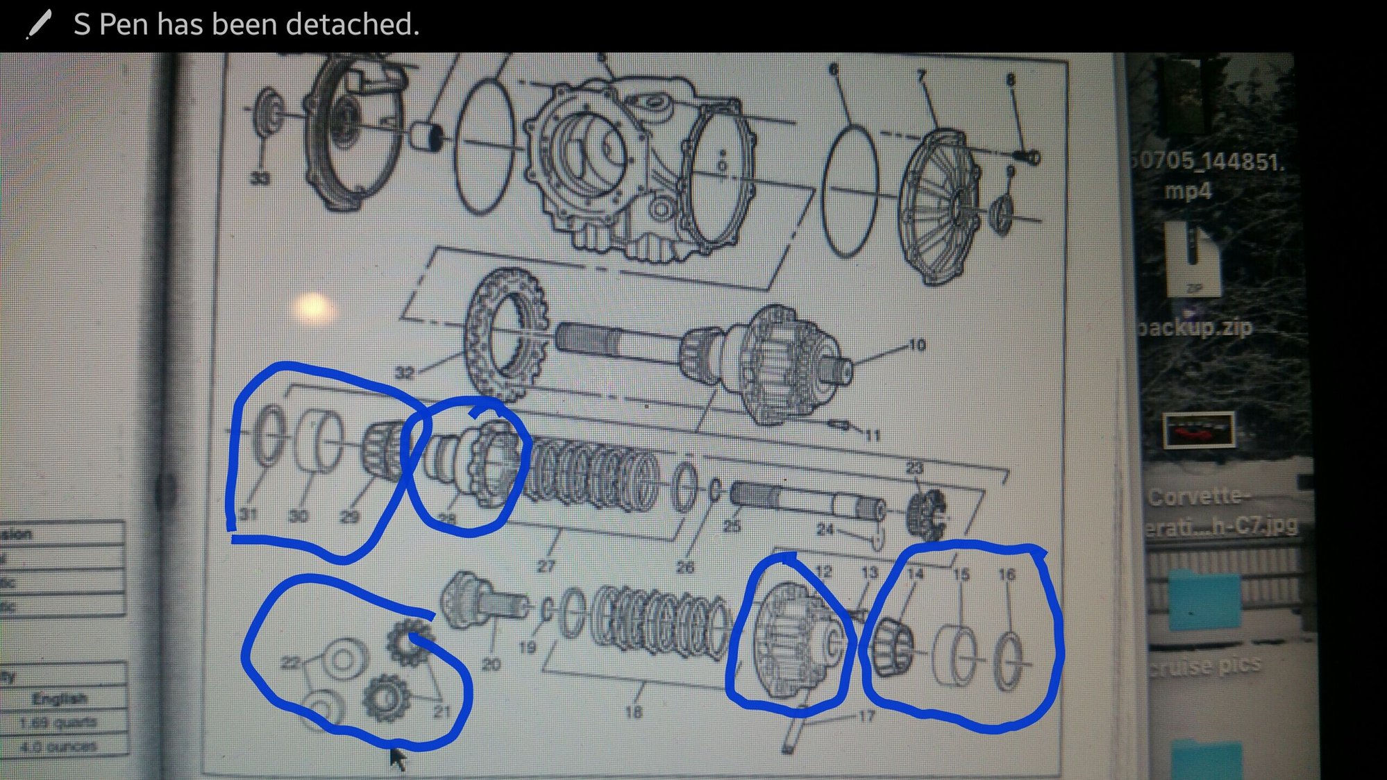

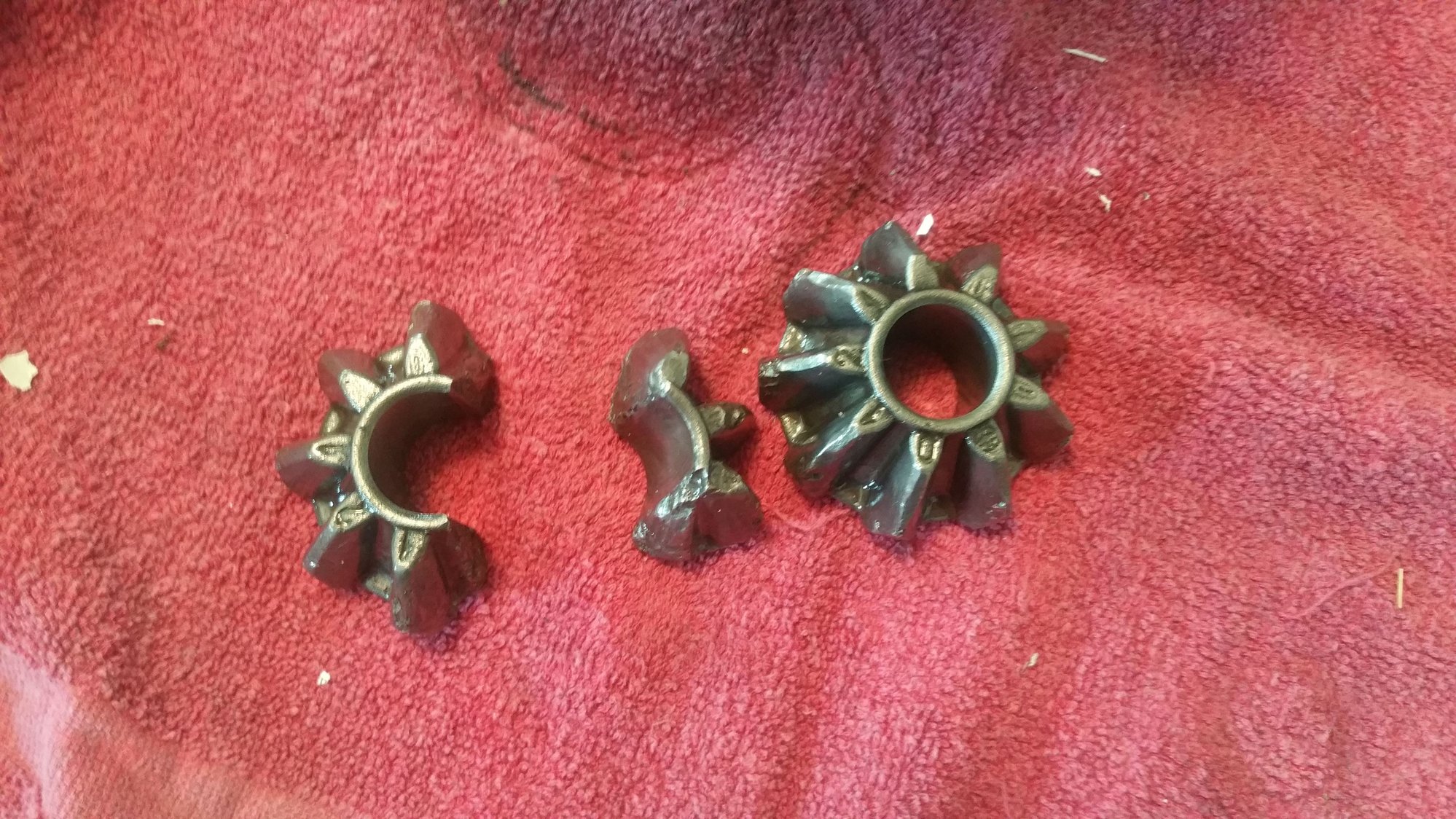

I need 2 spider gears. Both bearings and races. And the posi housing or carrier. I dont know what to call it.

Do you see what you are looking for in this file?
Plus pinion gear bearing and shims.
I bet if i get a new posi case i will have to get the gears reshimed and checked

SO,,,, It looks like you were the victim of a broken Beleview Spring for the clutch pack. When they fracture into multiple pieces that is what happens.
Bill
That would make since looking at the design of the inside posi casings. I have 1 guy working in it for me should have a response by in the morning. If not i will call rick. What ever i do i need to get it back together. Once i get the parts hope one of these local guys dont bend me over getting it back together.
