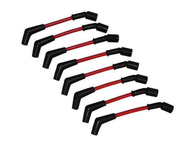

2) The wires I bought were different shaped then the originals. I didnt notice until I took them out of the box. Verified to make sure they work on our engines and they do but the metal shields no longer fit. Is that okay? I made sure the headers arent touching the wires but am still a tad bit worried. Has anyone used these with theirs/thoughts?
These are the wires I bought from a forum vendor.<br/>They are 8.5mm Street Series Spark Plug Wires

PUT YOUR FEARS TO REST! All is well. Wires will be fine. I like to use the shields but they are not mandatory.

they look like Hinson wires.
If yes installed a set and they look and worked great.
I have after market headers and they work well with the angle at the plug.
No shields no problem.
