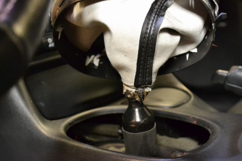

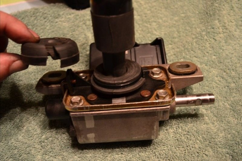

Make sure the box is CLEAN...(I cleaned mine with carb cleaner) where the shifter swivels in the neoprene ball or whatever it is...clean it and then put some wheel bearing grease on it ... The little boot on top of the shifter needs to be in GOOD condition or it will let sand, dirt, crap into your shifter box...
Mine as you can see was broke... I used some old 10 spd bicycle inter tube to make my own cover for it...
Also I trimmed off the OEM boot for the shifter and then zip tied it back to the shifter so it looks OEM...
The C6 shifter has a little groove where I zip tied it... then just roll the boot back down the shifter
All done...

He's WRONG... you'll still get $hit in your lower box if you don't fix that boot...
I already posted the FIX for that... the Z06 box and shifter I got was FILTHY... (should have got a partial refund too)
Anyway...use the method I posted about it worked PERFECT to fix that problem...
here are a couple of more pics...
THERE is NO way to get a NEW boot and get it on over the shifter... I suppose you could jack with trying to get the top separated but, I didn't think it looked like a good idea so I used the inner tube method...

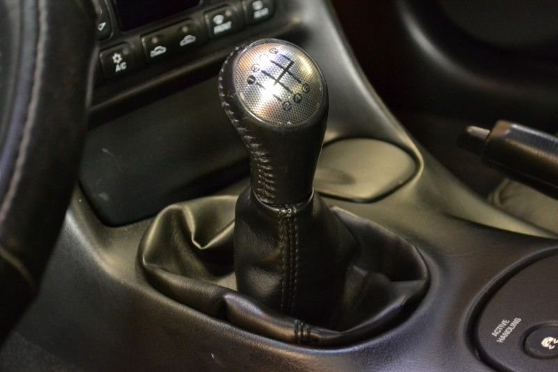

Old May 25, 2016 | 09:15 AM
Christian327's Avatar
Christian327
Joined: Jun 2015
Posts: 495
Likes: 36
From: Houston Texas
Progress so far..Waiting for the bezel/head unit. Also still have decide whether to 'fix' the c5 boot or go ahead and buy a c6 boot.
