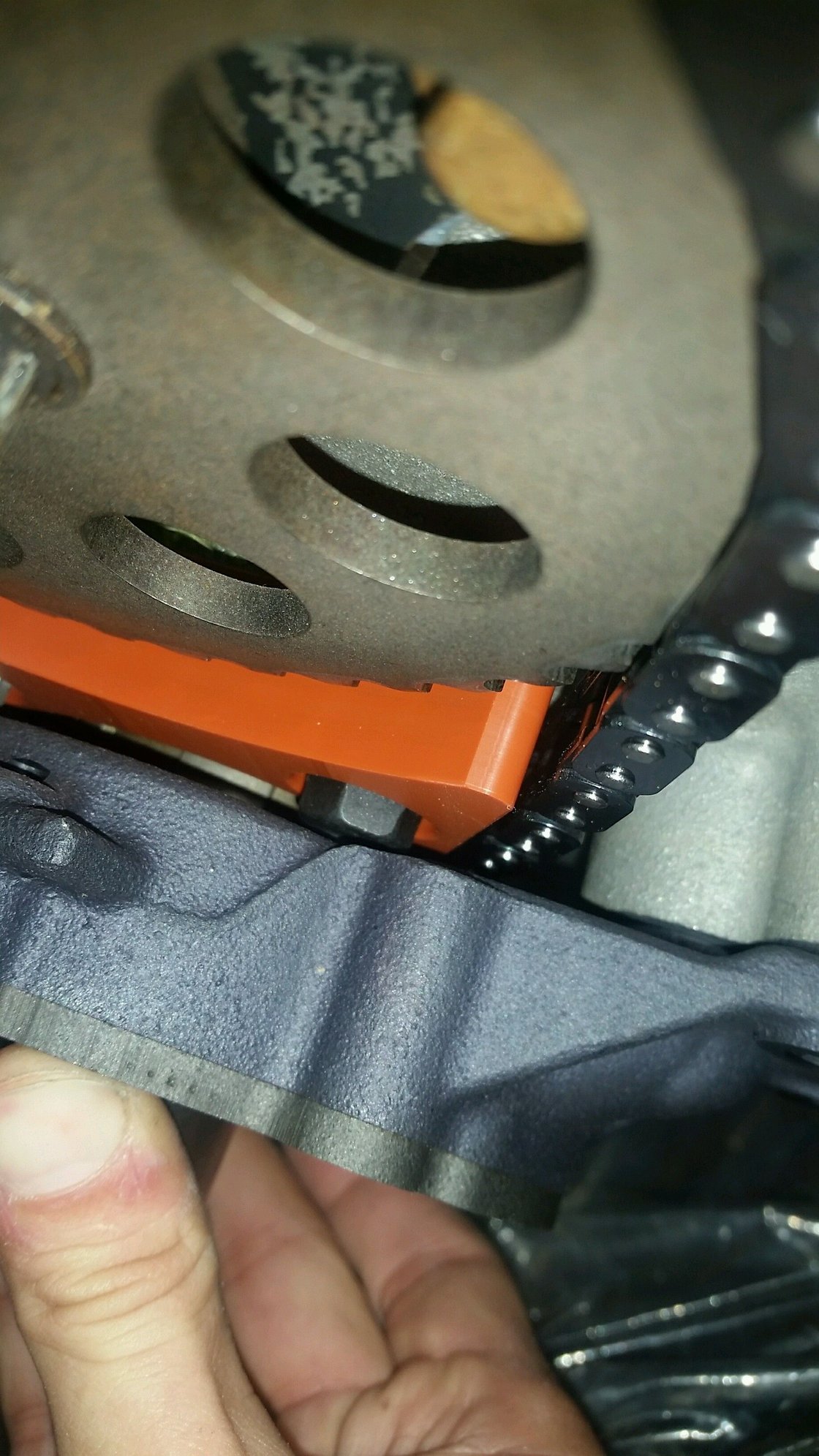

I only have a picture of mine installed on my 03 LM4
Old Jun 22, 2016 | 10:50 PM
sgtskid's Avatar
sgtskid
Joined: Jan 2005
Posts: 477
Likes: 21
From: Knoxville TN
Clears oil pump with ease.

Question: Is there sufficient width ("thickness") to provide support for double-row chains?
Old Jun 23, 2016 | 02:59 PM
sgtskid's Avatar
sgtskid
Joined: Jan 2005
Posts: 477
Likes: 21
From: Knoxville TN
Yes. Thickness is the same as an LS2 dampener and will provide plenty of support for a double roller.

Here's a stupid question since I know nothing about the hows/whys of engines. What is the purpose of this?
Old Jun 23, 2016 | 05:51 PM
sgtskid's Avatar
sgtskid
Joined: Jan 2005
Posts: 477
Likes: 21
From: Knoxville TN
Two things:
1. During high rpm runs the chain has a tendency to wrap around the gears which can cause premature gear wear and chain failure
2. At sustained RPMs the chain can start to vibrate at a frequency that causes failure.

So being made of plastic isn't it possible for the chain to eventually wear it down?
Old Jun 23, 2016 | 11:30 PM
LoneStarFRC's Avatar
LoneStarFRC
Joined: May 2001
Posts: 36,836
Likes: 244
From: Dear Karma, I have a list of people you missed.
St. Jude Donor '08-'09-'10-'11-'12-'13-'14-'15-'16
There is no full time contact, but over time it will eventually experience some wear, just like the factory pieces.
