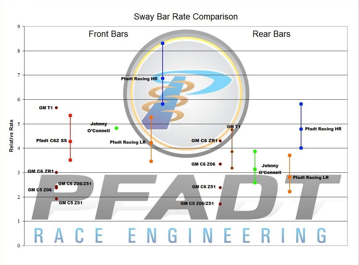

What I'm saying is you can have a 33MM bar made from say .080 wall steel, and a 32MM bar made from .100 wall steel and the smaller one may be stiffer than the larger one.
Just a heads up.

Old Aug 14, 2016 | 08:25 PM
