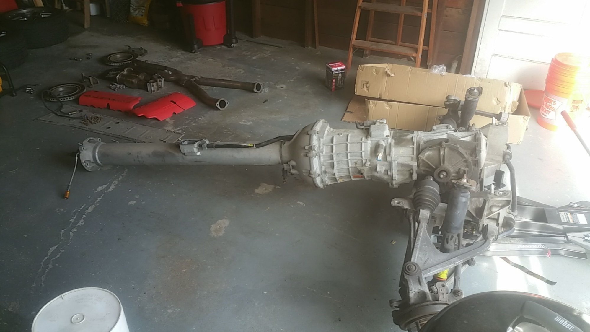

Old Aug 28, 2016 | 06:28 PM
Jeffdenney's Avatar
Jeffdenney
Joined: Jul 2016
Posts: 95
Likes: 10
Quick shot of the drivetrain yesterday after i got it removed from the vehicle. I used a floor jack under the torque tube, but I found it much easier to move the drivetrain by myself if I just held the torque tube and bossed the trans jack around with it. So that is why it is sitting on the floor right now..
Then I have the transmission in the trunk of my daily. Headed to RPM at 5am!
Sorry for the caption, it was a snapchat..
Am I gaining experience points yet?? lol

looking good, let us know how things go at rpm and what they discover

Originally Posted by Jeffdenney
There are SO many things that could be said about that picture, and it's caption. But I won't, as this discussion isn't in PR&C.................
Good Luck with the repairs!
I was thinking the same when I first saw it, at least I'm not alone
