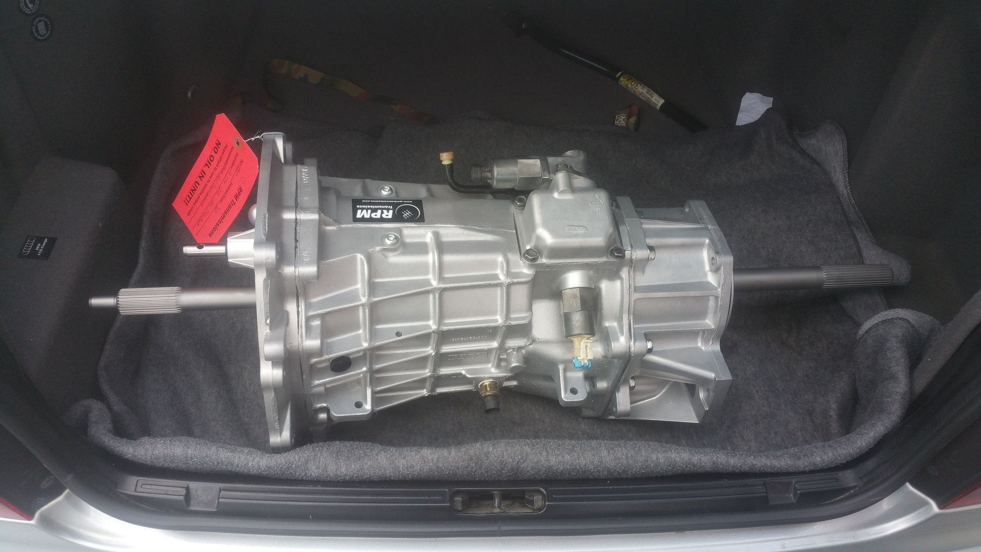

Got my trans back from RPM today. The guys there treated me really well. Let me ask all kinds of terrible questions and answered all of them. They definitely know what they are doing. I would suggest them to anyone and will surely be going back for any drive train upgrades in the future.
Seems the trans that was in my car was not the original trans that came in the car, it was a factory remanufacture or something like that. already had the steel 3/4 shifter fork and they said they tag wasn't the factory tag. Also it seemed to be in decent working order. Replaced my reverse gear because the syncro teeth were worn some and they said it would be an issue later.
This morning when I was checking to make sure everything was in the car that needed to be, I started fiddling with the shift rod on the trans and could get to other gears besides 3rd.. So now I don't know what the original issue was unless it was just a random fluke or weird bind. idk. at that point it was too late to turn back. I just wanted to eliminate problems and be sure of each part now.
I haven't found any other posts with similar issues to what I was having so at least my situation will be logged for any future instances I guess.
So my plan now is to basically test every single part that I put back on.
That being said, I ordered a new GM slave cylinder while I have all this apart, and will be reinstalling the drivetrain as soon as it arrives.
Then will be to inspect the shifter box on the MGW short throw to make sure it is not restricting anything.
Then I will be trying to check the master and most likely replace it with the tick adjustable unit. Then at least my entire drivetrain from flywheel back will be in order....
Now the slow process of ordering gaskets and fluids and slow reassemble.
wish me luck..
oh yeah and a pic of the tranny after she got all done up. lol

Well they didn't find anything wrong besides the reverse gear teeth that the syncro uses were worn. the teeth the outer ring slides onto..
So then they just did the stage 4 build.http://www.rpmtransmissions.com/page31.html
here is the link to their site and what I have... plus the bronze fork pads and a new reverse gear. mine was worn a little bit.
I already had it out and apart so I figured it might as well be built a little bit so I won't have to worry about it for a while.
