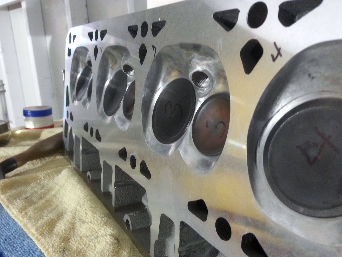

Default Got some new parts today🤗🤗
Just got my new MMS223 heads and can wait to put this set up together...

Default Cam specs
Originally Posted by vettenuts
Curious on the cam myself. I have the AFR 205 heads that Tony re-worked the chambers on along with the AFR 6016 cam. I also have his ported FAST 90 and ported oil pump, all before he struck out on his own. I can tell you the car is a blast to drive if you put your foot into it. I think you will be happy
He sent me a 227/232 on 113 with .613/.610 lift, heads are milled to 60 cc

Likes: 38
From: Colorado
holy compression batman! that thing's more milled down than my 243's, and these are at the limit as to what you can really do without a custom ground cam to meet PTV clearance. if his cam is made to match that, its definitely going to be an efficient little setup that doesnt sacrifice too much down low. post dyno #'s when you're done
