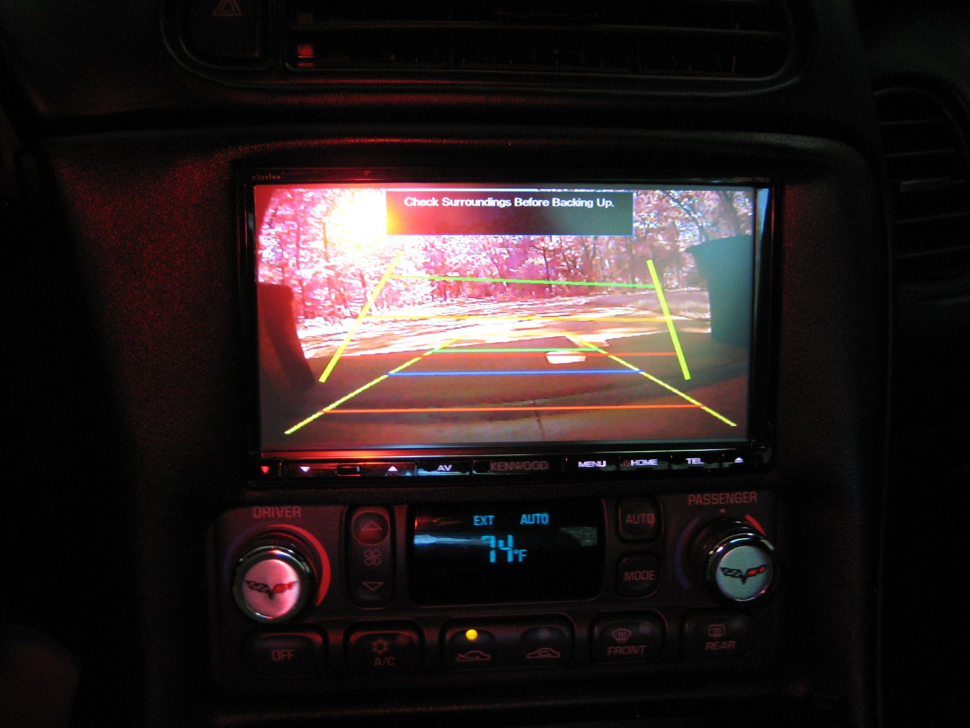

Pic of back up !!!
I can adjust the lines or remove them via the dash unit DDX793
