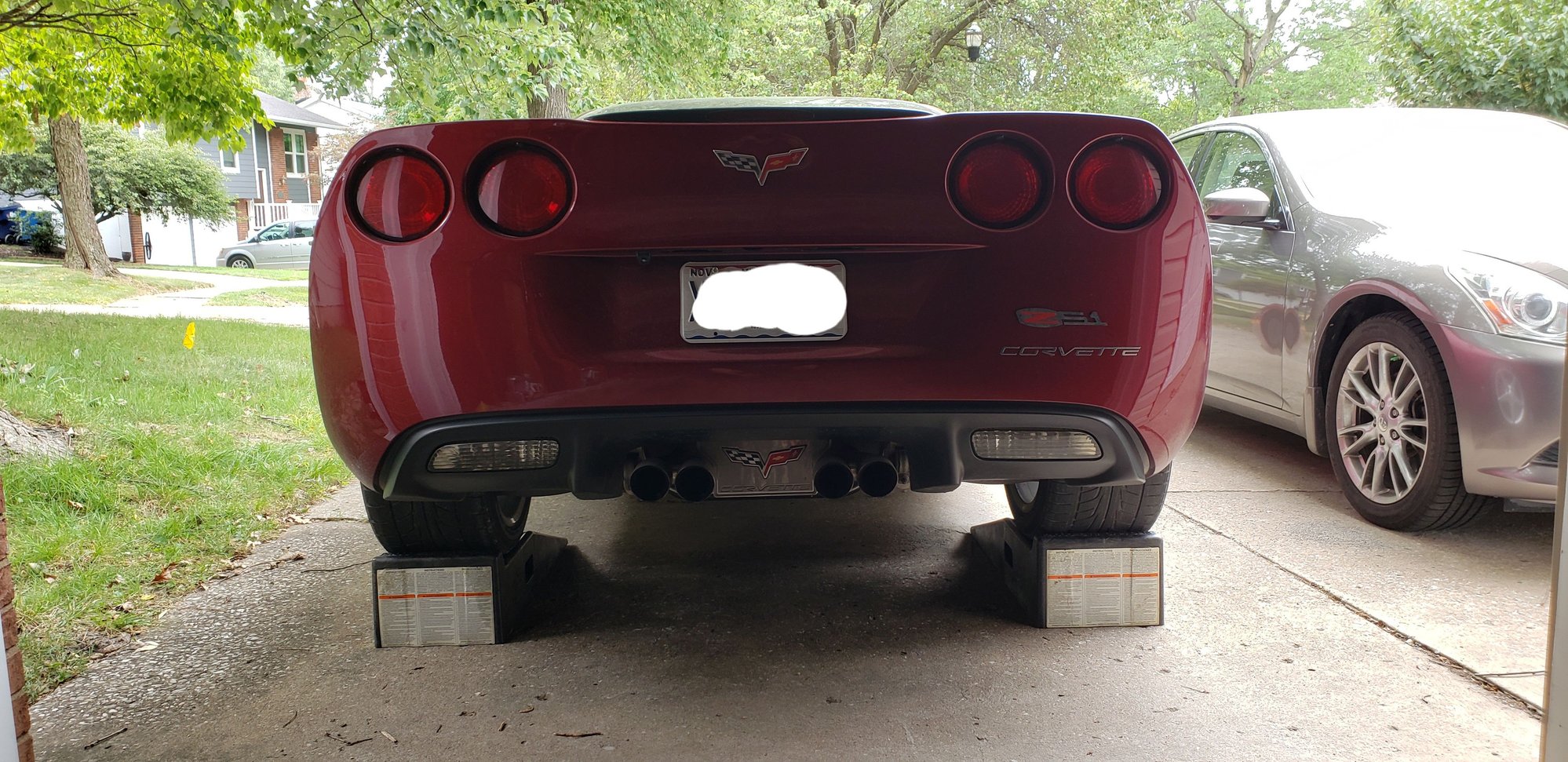

An old thread but I ordered mine new reverse solenoid a couple days ago. I opted for the entire piece with the housing (only $16 more). Someone said gear position does not matter but you can't get the new one in if the car is in reverse - ask me how I know
Job wasn't too bad . . . a bit tight.
One a positive note . . . When I installed my stereo and reverse camera the manual showed a reverse trigger in the factory harness. Unfortunately it didn't work, no signal when I put the car in reverse and had to manually go to the stereo menu to turn the camera on.
When I worked on the reverse lockout solenoid today I saw a wire connector unhooked on the side of the transmission (back up light switch). I assume they forgot to plug it in when they changed my clutch. I plugged it an and now when I put the car in reverse, the rear camera shows up on the screen automatically so that is good!
