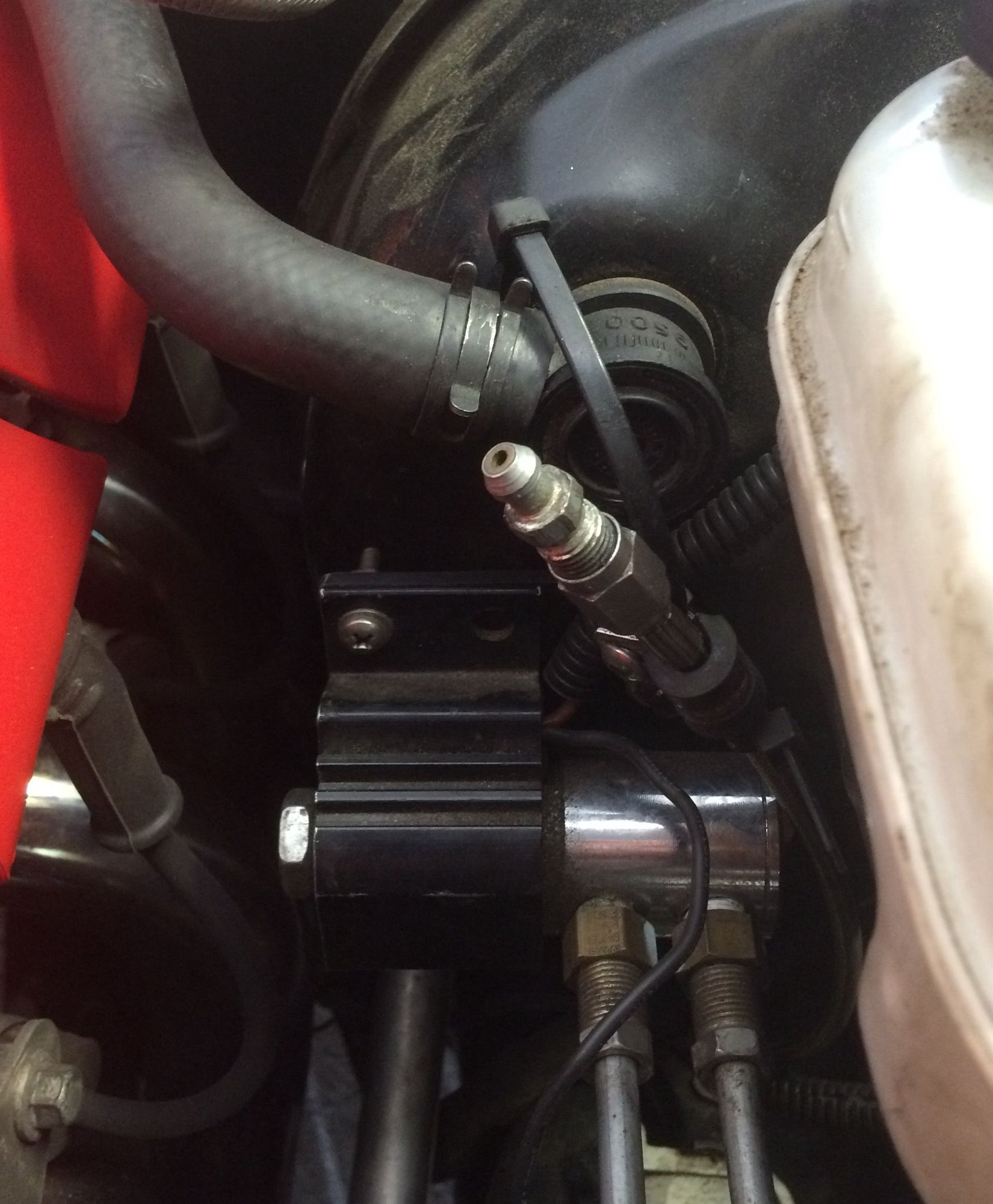

I've never seen a bracket for sale, I believe they are homemade, zipties work just fine to keep it out of the way. I cut cut it loose to use it.

Why would you want it mounted like that?
To bleed my clutch I open the bleeder, stick it in the full reservoir and pump the clutch pedal.
To clean the fluid, pull the dirty fluid out of the reservoir with a baster, fill with clean fluid, put line into a empty pop bottle and pump clutch till its clean.
With it mounted you make those two jobs much harder.

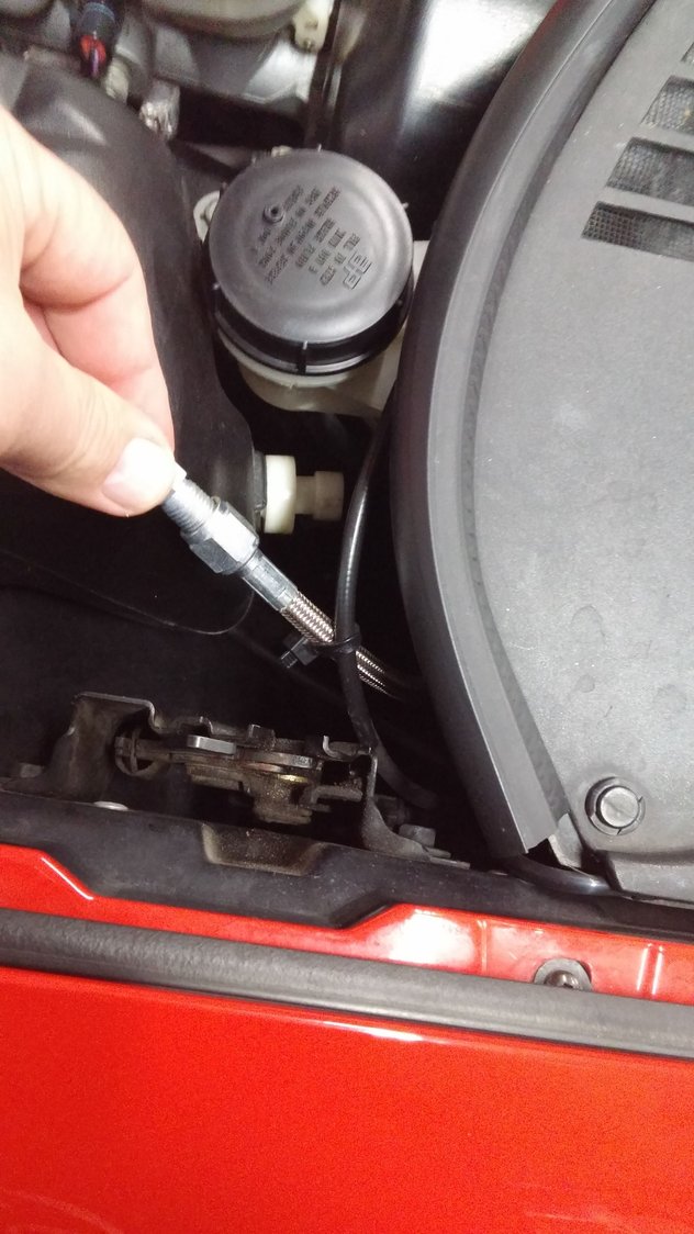

Well, how else should it be mounted under the hood? It seems like any other way it would just be flopping around in there. A ziptie could work, but just seems chintzy. I thought you could fit a clear hose over the end of the bleeder and then dip the other end in the container?
Ziptie is perfect, as 1,000's of Fbody and Vette owners have done.

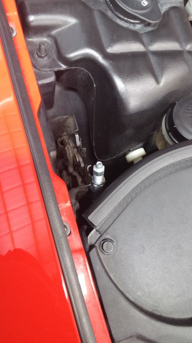

Mine is mounted right by my hood latch, I can pull it through the ziptie to use it, then pull it back through when done never disturbing the ziptie.
Where mine is it's not noticeable, but hey if you want to reinvent the wheel, more power to you. But when that "clear hose" pops off that bleeder and sprays your paint and under hood with brake fluid...better act fast.

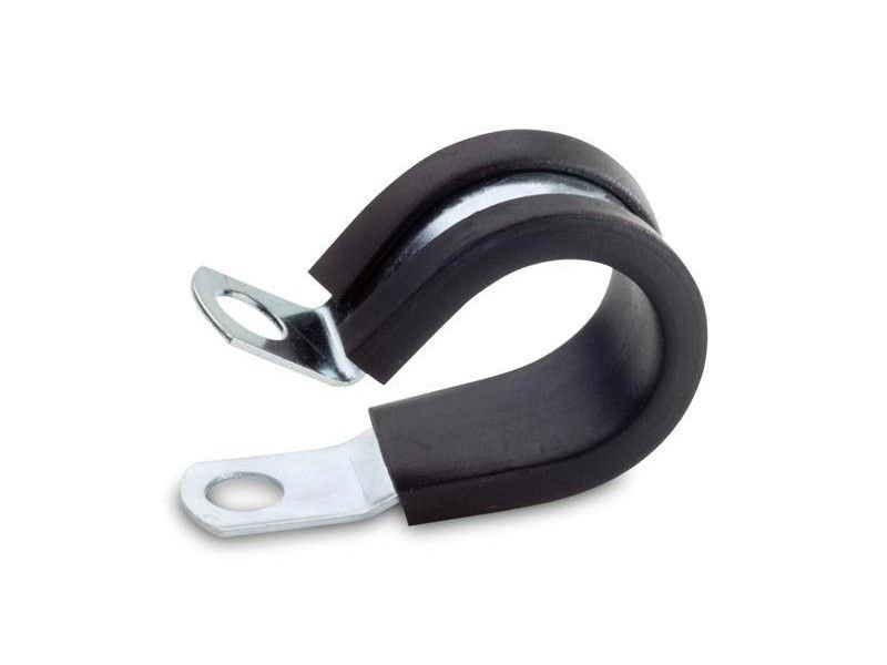

An Adel clamp would work where you want to mount it

You can probably find a clamp that will work at any hardware store, good luck.

Ok, so I got the car back and it's now installed - just laying in there currently but doesn't seem like it would go anywhere. Dumb question time, but do I need to tighten this thing down (the tip) so it's not letting any fluid out or anything? If I rub my finger over the tip of it, it feels greasy. If I wanted to bleed the clutch using this, what would I do? I really had it installed because it was one of those things that I saw recommended while the drivetrain is out, but I have never needed to bleed the clutch on a car before or use one of these. I didn't get any instructions at all, but it came from ECS.
Yes, tighten it.
You shouldn't have to "bleed" the clutch anymore but if you do, loosen the bleeder take the lid off the clutch fluid reservoir, crack the bleeder and submerge it in the fluid. Put something on top of if where it can't pop out and slowly pump the clutch pedal until no bubbles are seen. Close bleeder, you're done.
You should service your clutch fluid every time or every other time you change oil. To do this suck the old fluid out of the reservoir with a turkey baster, wipe clean with towel and fill with new fluid.
Take a clean old coke bottle and pour clean brake fluid in the bottom about a 1/4 full. Put a piece of 1/4 inch hose in the bottle into the fluid, crack the bleeder open and put the opposite end of the hose on the bleeder. Pump clutch pedal until fluid is clean, DO NOT let reservoir run dry.

The shop probably did tighten it, but how can I be sure I'm not overtightening it? Will that greasiness at the tip just completely go away once it's tight or can I push on it a little or something to be sure? It's quite possible the little bit I saw in the engine bay around it is from where they bled the clutch and just didn't clean it up and it may not be loose at all right now.
Use 2 wrenches and tighten it. Turn it upside down and tap it into a paper towel.
