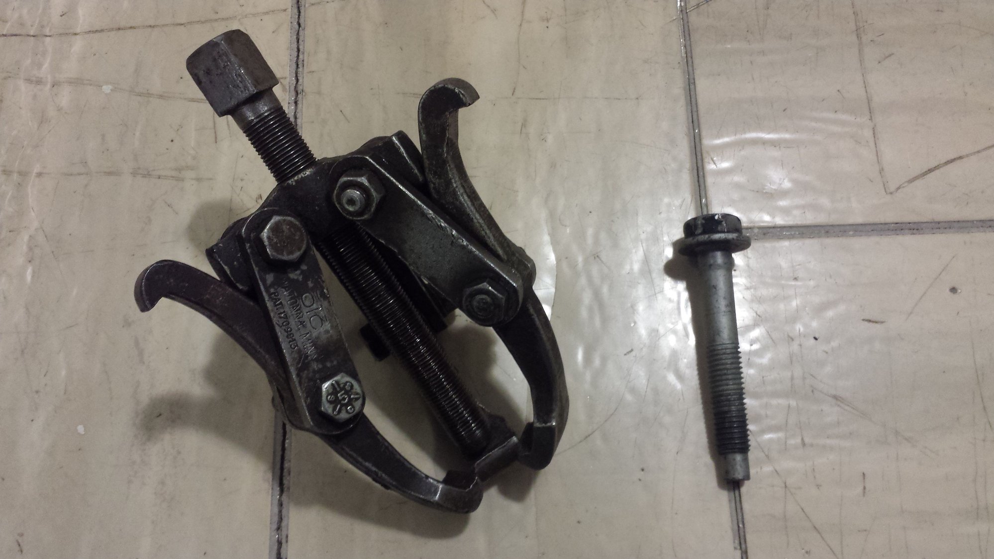

Hello everyone, having problems with trying to remove the crank sprocket. I rented the pulley from autozone, but the bolt is to short and bottoms out before beginning to pull at all. I put the main bolt back in the crank, but then the tool is to short. Looking for possible ideas.

Auto zone offers 3 pulley pullers, the biggest one is way too big. I used one of the two smaller ones and possibly one of the studs included in my otc damper pulley. For reinstall I bought a foot of pvc that fit onto the lip of the crank sprocket, set a piece of 2 x 4 on top of the pvc and hammered on the 2 x 4 sitting on top of the pvc while standing the crank up.

Guys, he's not talking about the crank pulley, he's talking about the crank sprocket that the chain wraps around. On second thought I think I put my old crank bolt back in the snout but didn't torque it down and used the 3 arm or 2 arm pulley to push against that while pulling the crank sprocket off. The crank snout is keyed for the crank sprocket. The official tool is a small fortune from kent moore on ebay if you want to give that a shot... Kent Moore J-41558.

I agree with the post above mine. I did the exact same thing. The only thing different was i applied heat to the old sprocket while pulling on it.
I got my pullers from Harbor Freight in a set of three for less than $20.00. Worked great. Also used one of them for removing the dampener.

I got it I borrowed a puller and it worked. The pullers from autozone and o'reilly's were either to small or to big. I don't know the size of this puller, but it worked perfect. I used a bolt from the power steering rack inside of the crank to have something for the puller to push on. Thanks for all the suggestions and ideas.
