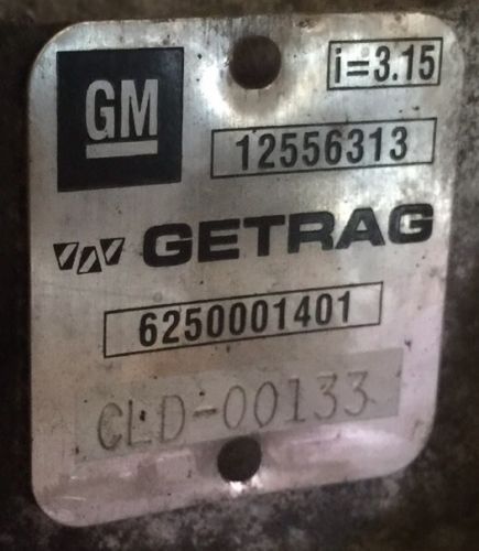

How would I go about checking on the gear ratio? Where would I find that info.?

Originally Posted by Skyhawk23
GrantV,
Thanks
should have a tag like this on the diff.
Pounder,
Thanks. I will have to take a look this weekend and report back.
