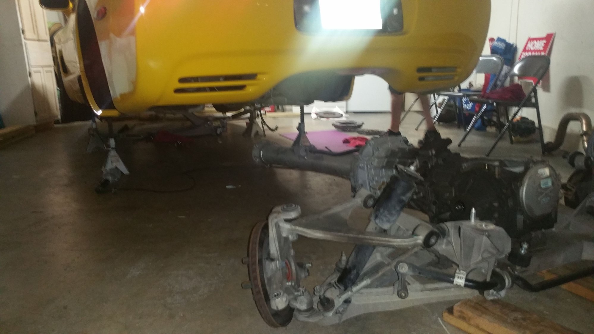

Ive got a mcleod rxt and new slave in mine. My buddies 03z has 50k miles on it and at the track last month it started doing the same issues, we just put in a mcleod rst in his with a new oem slave!
We did this in the garage!!
Last Wednesday nite. In 3hrs put the car in the air and removed cradle, diff trans tt 1piece, then the clutch and flywheel.
Thursday took flywheel to machine shop to get resurfaced. Then installed the clutch and tt and bleed with new remote bleeder, about 2hrs.
Saturday night. 4hrs install trans and diff together, then cradle.

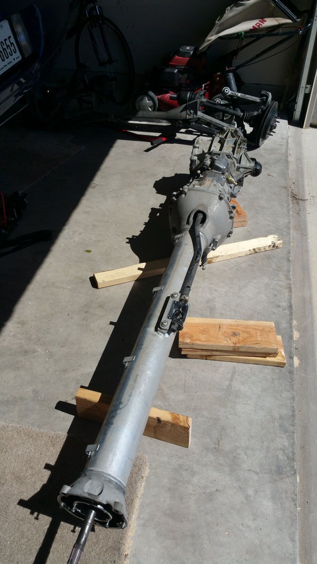

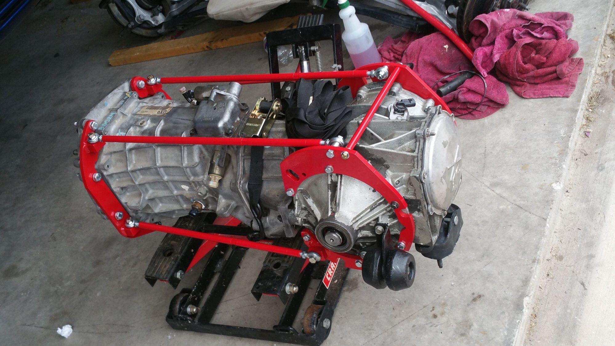

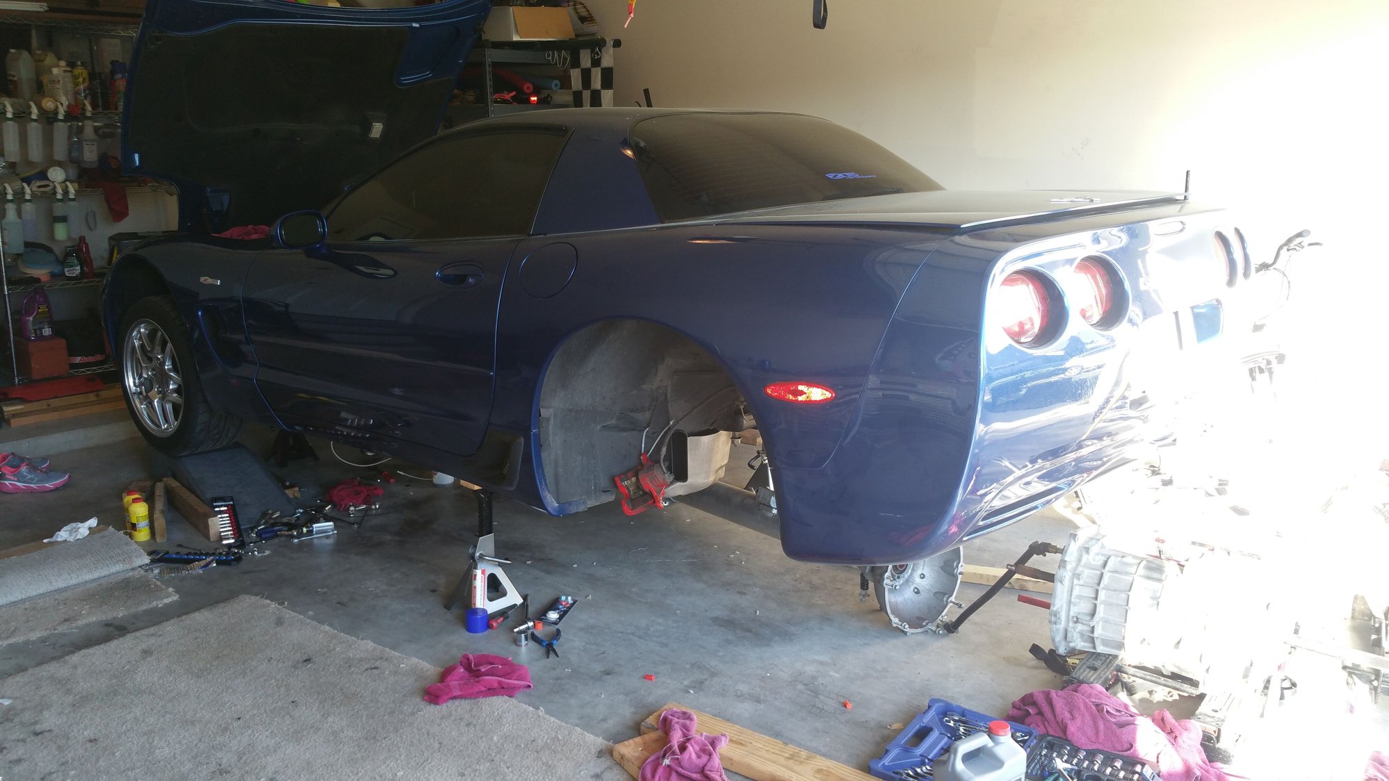

Just wanted to post an update, everything has been going really well just taking a very long time since I'm doing it all by myself. I have a couple of questions but first here's some update pics:
Out with the old
and in with the new!
I noticed the new flywheel from the Tick Performance LS7 clutch kit is A LOT heavier than my stock LS6 flywheel. Will I notice any issues with that? I like how fast the revs drop when I push in the clutch instead of hanging up a bit before falling down like my C6 that is in my avatar.
Should I smear some oil on the crankshaft seal before I put the flywheel and new clutch on just to help prolong it's life?
