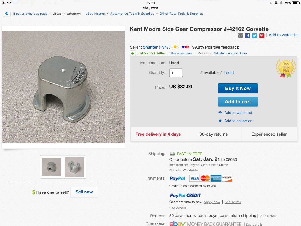

Replacing the clutch packs/washers/output shafts is a pretty straight forward process.
This tool is a big help getting the stuff apart.
Have fun and good luck with your project.

The tool Capthuff shows is nice but not necessary.
A bearing press is needed though. Just use some sort of small round shaft that will press on the part. That's all I did.
Would you say this is the only special tool needed for the upgrade (shafts, clutches, bellville washers)?

Well, - a torque wrench and a press would be helpful. But no other real specialty tools needed.

I just did this job and I used that special tool and a hydraulic press from harbor freight. A torque wrench is needed also. I used a wrench on the diff to hold the diff case bolts while I torqued to 41 ft/lbs.
