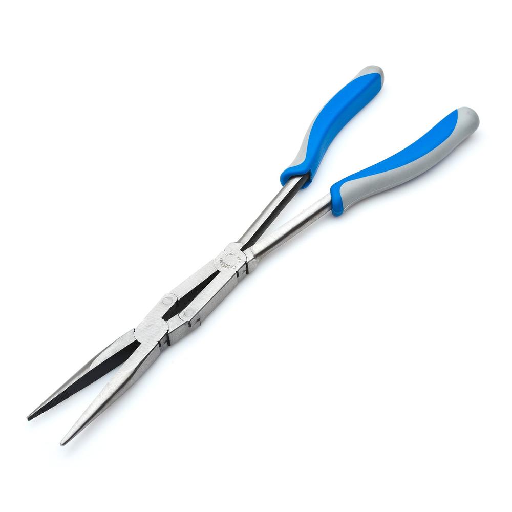

I bought these,
Amazon Amazon
... the large straight one works perfect for the torque tube snap rings, I have used it a handful of times and it comes off in a breeze... I chose to get this set in case I needed it for any other reason and I ended up needing it a few times to do trunnion upgrades as well... if you don't want to spend that kind of money you can get a cheap set of needle nose and grind the tips down but I find the correct pliers much much easier for the job
