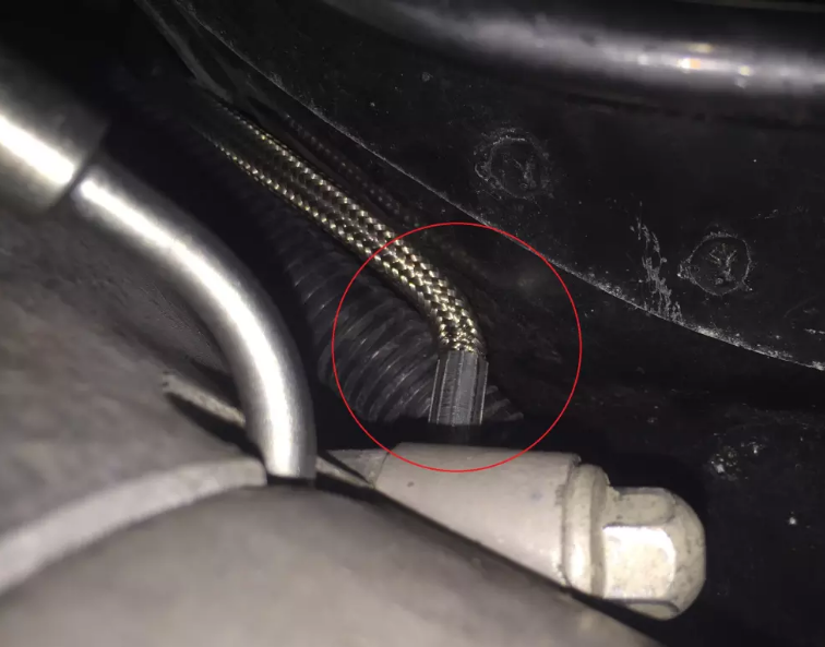

I ordered the kit from Speedway Motors. As designed, it forces the end of the hose where it goes into the fitting against the top of the TT tunnel, causing a bend in the hose (see red circle in pic).
I added a 90º -3AN swivel fitting, like this to redirect the hose so it doesn't bash against the TT tunnel.
ETA: I added the 90º fitting after the fact. I wasn't comfortable with the hose bend, so I dropped the drivetrain and added the fitting, for peace of mind.

That sucks, how far back together did you get before you realized there was a problem?
