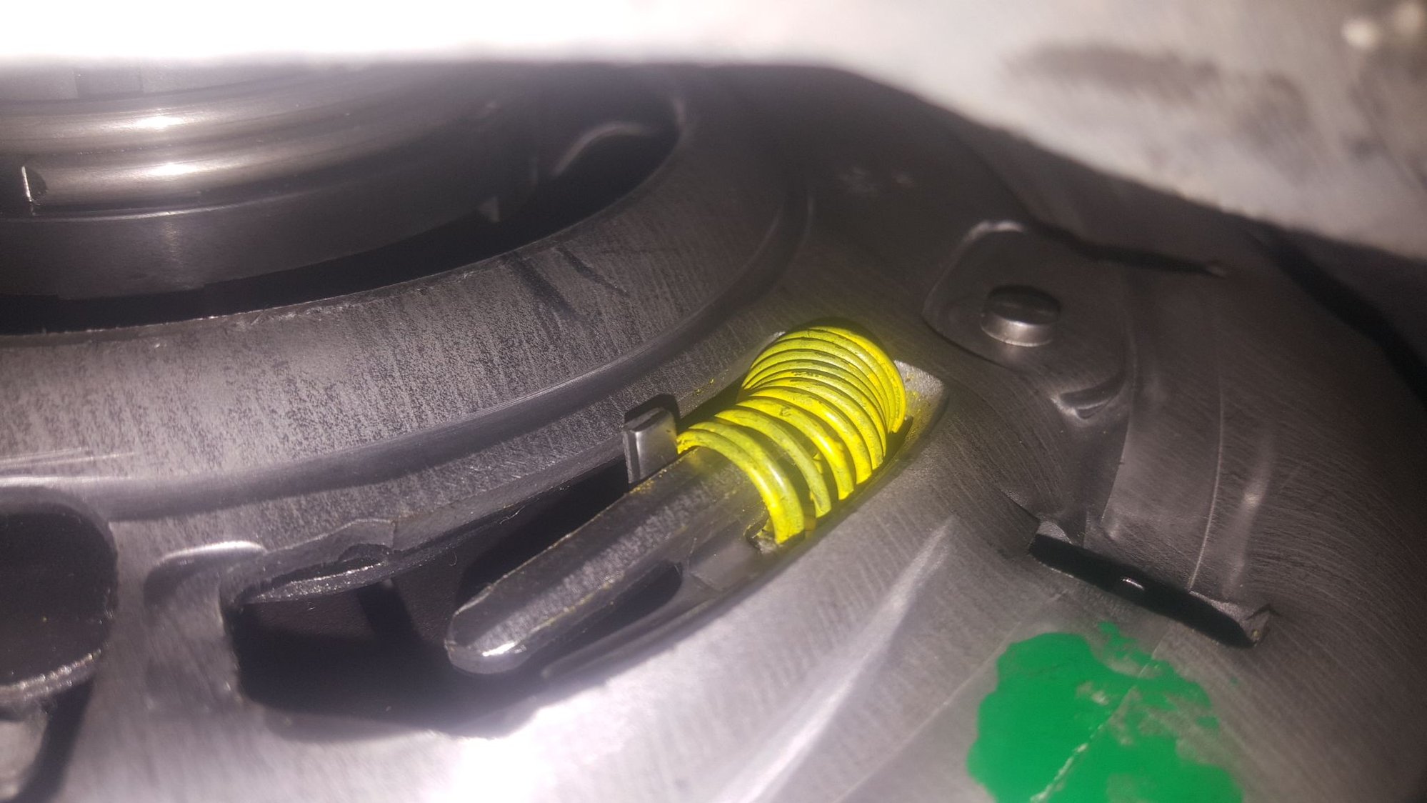

Originally Posted by feeder82
here is the procedure to set the self adjustment on the ls7 clutch you can do it in the car, they should mention this in the kit but they dont, this is probably why its not disengaging
http://paceperformance.com/files/pdf/zo6clutchadj.pdf
Do you think the spring is fully compressed?
It looks fully compressed

~Josh's Avatar
~Josh
Banned Scam/Spammer
Joined: May 2007
Posts: 15,685
Likes: 1,330
From: Machineguns, because I don’t compromise
Yes, that's compressed. Looks good.
