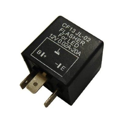

In our cars the turn signal and hazard functions are provided by the hazard switch. The hyperflash harness replaces the portion that handles the turn signals with a flasher that's LED friendly. Hazards will still hyperflash because that function remains untouched in the OEM hazard switch.
Since you already have a hyperflash harness installed, the hazard switch is not controlling anymore the turn signals flashing action. It is possible that the flasher in the hyperflash harness has failed. You could try replacing it. It is not expensive and it is easy to do.
You can use a LED flasher like the one below. It can handle loads from 20mA to 20A without a problem.
Amazon.com: 3-Pin CF-13 Electronic Flasher Relay Fix For LED Turn Signal Light Bulbs: Automotive Amazon.com: 3-Pin CF-13 Electronic Flasher Relay Fix For LED Turn Signal Light Bulbs: Automotive

so does this module you picture replace the Radio flyer hyperflash module, or is this wired in with the radio flyer module still in tact, Thanks

A hyperflash harness is just a LED friendly flasher wired with a pair of male and female connectors, so it can be inserted without having to cut or splice any wires (see picture below). It would be a matter of just replacing that flasher with a new one. Just pull the old one from the harness and put the new flasher where the old one was. You'll probably won't even have to remove the harness to swap the flashers.

Problem I am having is the radio flyer harness flasher has the B/+-E/- terminals flipped compared to all other LED relays , the parts guy at Orielly said it doens matter but I inserted into where the old one was and the turn signals dont even show up at all , compared to the original flahser in the module where the turn signals flash until they stay on solid after a few minutes
You need a LED friendly flasher with the terminals in the same position than the hyperflash harness' original flasher, otherwise you would need to relocate the flipped wires in the socket to make it coincide with the terminals of the new flasher.
How are the terminals of the hyperflash harness' original flasher compared to the one from Amazon (CF13JL-02)? Are they in the same relative positions?
Backwards which changes the polarity of the switch, Radio Flyer was nice enough to send me a relay free of charge, so I will try that before I venture into the Hazard switch
